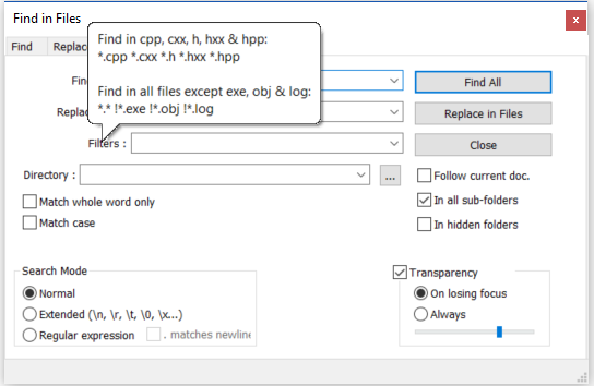

      I’ve added a Pull Request to include that example in the Searching > Find in Files docs. It should be merged by this weekend; when it gets released is out of my control.
        I found the tooltip that provides help on the feature.
        It wasn’t where I expected it.
        I expected it to appear when you hover (and stop moving the mouse) over the box you fill in for the filters, but no, you have to point to (and pause over) the Filters : label itself:
