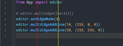

      Looking at your macro, I agree that you are calling the Scintilla messages for SCI_SETEDGEMODE (2363) and SCI_MULTIEDGEADDLINE (2694). My first guess for your problem is that you’re passing lParam="0xAAAAAA", which might not be translated to a number between the XML and when the message gets sent. I tried implementing that macro, but with lParam=“11184810” (which is the decimal equivalent of 0xAAAAAA, but it still didn’t work.
      If PythonScript is missing a message that you want, you could always make a request at the PythonScript github issues. And since you have the full power of Python, you should be able to find the library where you can get direct access to the Win32 API’s SendMessage function in Python; with that, and the scintilla HWNDs – which you can either get from a PythonScript command (I don’t remember for sure if there’s a wrapper for those), or you can enumerate windows to find them – search EnumWindow in the forum for examples of that)

            Working LuaScript code:
            editor.EdgeMode = EDGE_MULTILINE
            for i=1,10 do
            	editor:MultiEdgeAddLine(i*8, 0xBBBBBB)
            end
            And then I just manually change the color to 0xFFFFFF and re-run it to clear the lines. The current reason I can’t use it as a one-button solution is that the menu options presented to me are either run code from the console (so I would need a macro method of putting arbitrary text in the console which I haven’t been able to determine) or run it from the current file (which requires a macro method of loading a specific file which I haven’t been able to get working with any sort of consistency).
