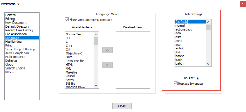

        • Alan KilbornA Online
          You can change globally here, or just for Python files:
          Ralph CramdenR 1 Reply Last reply Reply Quote 2
          • Ralph CramdenR Offline
            Ralph Cramden @Alan Kilborn
            @Alan-Kilborn SOLVED! I realized that I had to select Python in the drop down box, not leave it at [Default]. Thanks very much!
