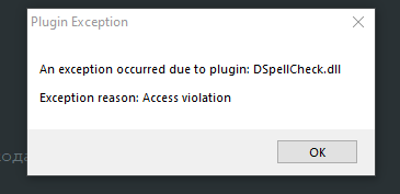

    • makarovproM Offline
      makarovpro
      I install the plugin dspellcheck and when you start the program constantly there is such an error, the program was installed by the administrator.

        • dinkumoilD Offline
          dinkumoil @makarovpro
          @Евгений-М
          Since
          it could be that in C:\Users\<your-user-name>\AppData\Roaming\Notepad++ some files required by the plugin are missing. They could be found under C:\Users\<admin-user-name>\AppData\Roaming\Notepad++. Please contact your admin to have a look at that and maybe to copy over the missing files to your user profile.
          If that doesn’t solve your problem we need some info to be able to help you. Please go to (menu) ? -> Debug Info, copy the debug info to your clipboard and post it here in the forum.

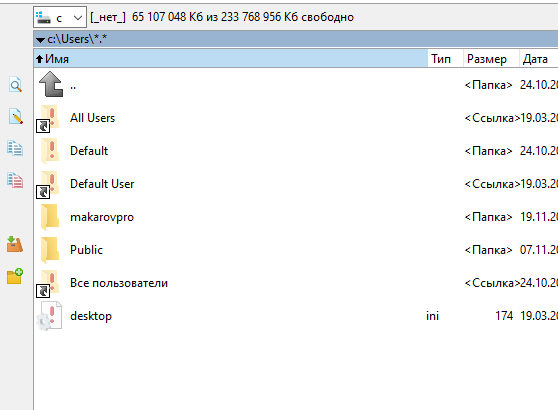

                makarovpro @dinkumoil
                @dinkumoil I do not have a user ADMIN there is no such directory, see the screenshot. The main user of makarov pro is also an administrator.
                  @makarovpro
                  OK, thank you.
                  At next I recommend you to download a portable version of Notepad++ and unpack its ZIP file to a folder of your hard disk where you have write permissons. Then install the DSpell plugin using Plugins Admin and check if the crash happens in this clean Notepad++ installation as well.
