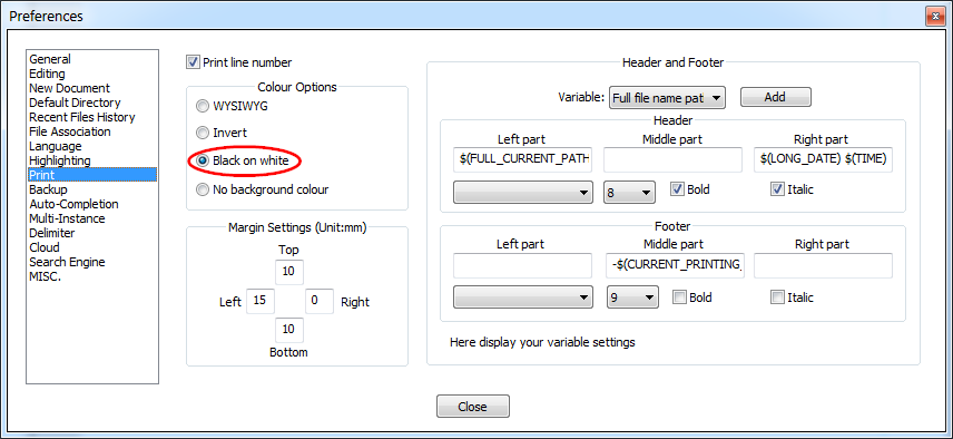

      Hi,
      A similar question was asked in 2017 and it wasn’t answered so I’m asking again.
      Currently I’m using a black background with yellow color font. It looks well on screen, but the print out is unreadable. The font is faint (guess it is because it is yellow color).
      So, how do I fix it?
      Thank you
      Henry
      • dinkumoilD Offline
        dinkumoil @gnulab-id
        @gnulab-id
        You can set printing to “Black on white” in preferences Dialog:
