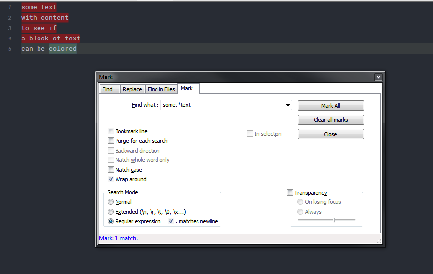

              Ekopalypse @IBIT_ZEE
              @IBIT_ZEE
              If I understand correctly you are looking for something like this !?
              Basically, you want to enhance an existing UDL or builtin lexer, correct?
