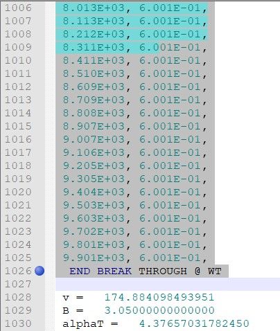

                          (image below is the bottom of one selected block).

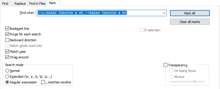

                            I have great luck with your scenario when I do the following bookmarking operation, even when there is ~1000 lines (it’s what I tried anyway) in the block:
                            If you want to try exactly that, here’s some copyable text: (?s)BREAK THROUGH @ WT.*?BREAK THROUGH @ WT
                            Note that I didn’t use END for the trailing text matching, as it isn’t strictly necessary, but it could be added and should also work.
                            The key to this technique is the new feature in N++ 7.8 which will bookmark each and every line making up the marking match. Previously, only the first line of a multiline match would receive the bookmarking, although the entire match would receive the red color.
                            After you bookmark the text this way, use the feature to copy bookmarked lines to the clipboard for pasting elsewhere.

                              Unfortunately “Mark All” doesn’t cover the entire selection (it missed 16+ lines in the image above)
