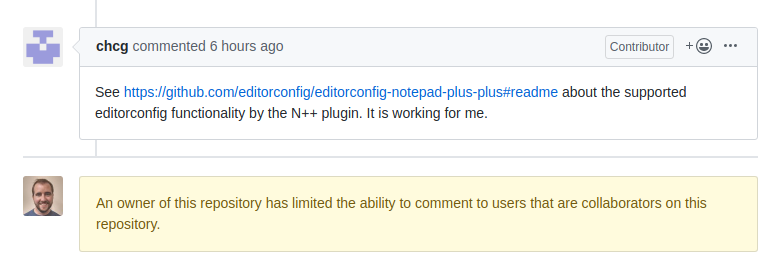

 I’m commenting here in response to @chcg on the GitHub issue this (#6183) because I don’t seem to have permission to comment on the GitHub repo anymore
 The EditorConfig plugin that was linked to is the official one that we (Hong Xu really) made years ago when we created EditorConfig. Unfortunately the existence of the plugin isn’t adequate for my use case. I have anywhere from 2 to 20 hours with my students depending on the course and every minute we spend setting up their machines takes time away from our learning together. Currently I send them a set of instructions to go to Settings -> Preferences -> Language and change the appropriate settings for Python to set their Python settings to 4 spaces. If EditorConfig was built-in to Notepad++, I wouldn’t need to do this. I’m hoping that Notepad++ will add built-in support for EditorConfig, just as BBEdit, Komodo, Visual Studio, PyCharm, and other editors have done. Alternatively, I’d love to see the tab/space default preference reconsidered, as it’d at least help students who do a fresh Notepad++ install. I’ve probably helped about 300 people change this preference on their machine over the last few years, so that they could work with most Python files.
