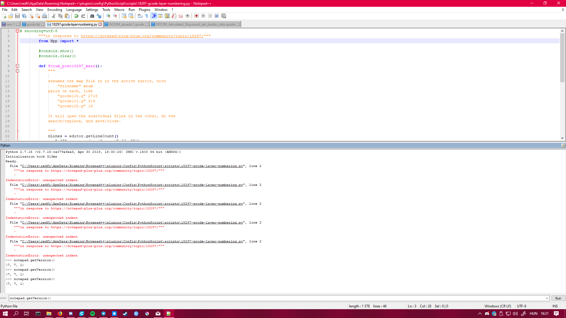

      Okay, so I managed to install PythonScript. In theory I created the script (made the file, copy pasted your script and saved as you said (18297-gcode-layer-numbering.py))
      I created a new file wich contains the directions for the folder I have my gcode files in, saved. But when I start the script, nothing happens. Literally. I click on the 18297-gcode-layer-numbering script and nothing.
      I would show some effort, but I really don’t know how this works. I follow your instructions, but for example I have no idea what the script contains.
      Thank you very much for this, i don’t know what’s wrong.

              Sorry, I forgot that since you were decoding it, the forum wouldn’t gobble the indents.
              In the script, Ctrl+A to select all, then Shift+TAB twice to un-indent twice. Save. Then go back to your map file and run the script again.
                  @PeterJones said in Mass editing G-code:
                  then go back to your map file
                  You’ll also want to make sure your map file isn’t indented. Again, select all and Shift+TAB until it’s no longer indented.
