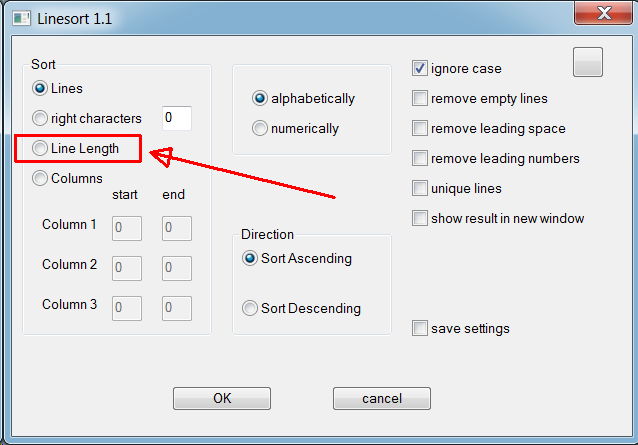

        freezer2022 @Dave Pruce
        @ Dave-Pruce said :
        Is it possible to sort a file by line length??
        Yes, not natively, but there is a Notepad++ plugin for it: Linesort v1.1 (but only for 32bit Notepad++) :
        https://webarchive.org/web/20200207125518/http://www.scout-soft.com/linesort/

                @Thomas-Knoefel
                I received a feature request related to this post. It doesn’t quite feel like a good fit for Columns++ to me, but I think your MultiReplace plugin can assist in making this possible in a reasonable number of steps.
                I believe multi-replace can be set up to find ^.*$ and replace with set(string.len(MATCH).." "..MATCH).
                Then Edit | Line operations | Sort Lines As Integers Ascending will sort the lines in order by length, and then ^\d+\x20 replaced with nothing would remove the lengths.
