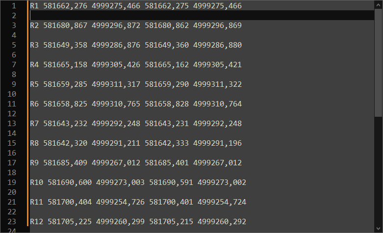

                  • Slobodan KrstićS
                    Slobodan Krstić
                    Re: How to insert blank line in between every line
                    Using column selection (alt - left mouse btn)
                    press enter
                    Maybe the fastest way :))
