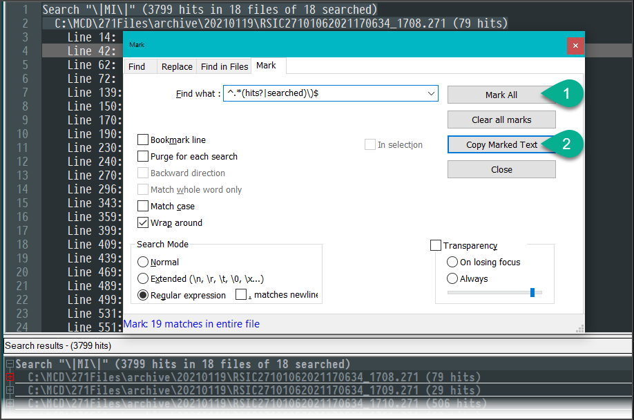

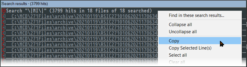

                    With Notepad++ v7.9.2
                    • Right-click anywhere inside the Search Results, and select Copy.
                    • Paste into an new empty file.
                    • Ctrl+M to invoke the Mark tab
                    • Use this search query ^.*(hits?|searched)\)$ and click Mark All, then Copy Marked Text
                    • Paste over the text that was previously pasted and then searched. The collapsed results are all that remain.
                      Alan Kilborn @iamhammer
                      @iamhammer said in Collapse function - how to copy just the collapsed results from results window:
                      Wouldn’t you have to select something first?
                      iamhammerI 1 Reply Last reply Reply Quote 0
                      • iamhammerI
                        iamhammer @Alan Kilborn
                        Yes, you need to have a selection.
                        I’ve changed my colors around in the theme settings and haven’t yet found the balance I am looking for. It’s made it a bit more difficult to notice that I did indeed have a selection.

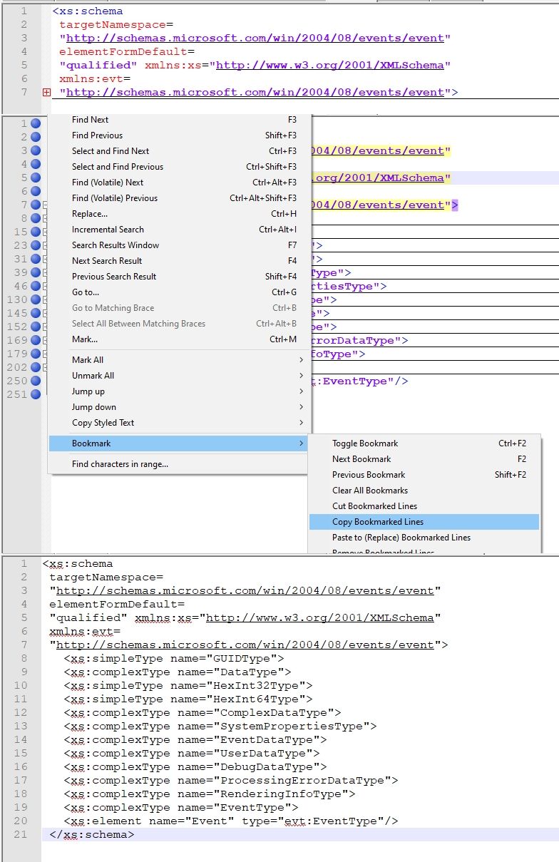

                        • haleba-hotmailH
                          haleba-hotmail
                          Old thread, but FWIW since I had the exact same issue:
                          View/Fold All
                          Unfold the top level to expose all second level folded items, then set bookmarks on the visible lines (do NOT try Invert Bookmarks: it looks like it only bookmarks the visible lines but actually marks ALL the lines)
                          Search/Bookmark/Copy Bookmarked Lines
                          Paste in new document.
                          Done
                            Hello, @haleba-hotmail and All
                            I cannot reproduce your N++ behaviour. You must run an old N++ release !
                            With the v7.9.2 release ( note that the latest is v7.9.5 ) if I fold and bookmark, in any N++ XML configuration file, the <NotepadPlus> tag, then, after using the Search > Bookmark > Copy Bookmarked Lines option and pasting the clipboard contents in a new tab, I only get one line : the <NotepadPlus> line !
