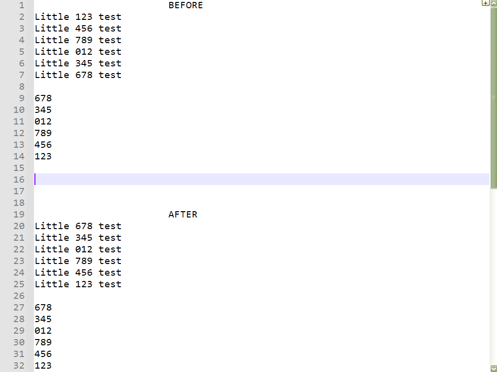

                                Hello, @don-bhai, @alan-kilborn and All,
                                I may misunderstand what you want but are you looking for this kind of manipulations, below, which seems to work nicely ?
                                I assume that the BetterMultiSelection plugin is installed, with its last 1.4 version ( IMPORTANT )
                                I personally tested with N++ portable v7.9.2 (32 bits )
                                So :
                                • Paste the text, below, beginning with a blank line, in a new tab
                                Little 123 test
                                Little 456 test
                                Little 789 test
                                Little 012 test
                                Little 345 test
                                Little 678 test
                                678
                                345
                                012
                                789
                                456
                                123
                                • Move the caret at beginning of line 9
                                • Hold down the Alt and Shift keys and hit 5 times on the Down arrow key
                                • Hit the Shift + End shortcut, once
                                • Hit the Ctrl + C shortcut
                                • Hit, 7 times, on the Up arrow key
                                • Hit, 4 times, on the Right arrow key
                                • Hold down the Shift key and hit 3 times on the Right arrow key
                                • Hit the Ctrl + V shortcut
                                • Hit the Esc key to cancel the multi-selection !
                                As you can see, in the picture, below, each number, from line 27 to 32, have been pasted, accordingly, in lines 20 to 25 ;-))
                                Best Regards
                                Alan KilbornA Don BhaiD 2 Replies Last reply Reply Quote 2

                                        • Don BhaiD
                                          Don Bhai @guy038
                                          @guy038 you are amazing, thank you very much
                                          i was selecting the 6 word by ctrl+A
                                          thats why it replace every word by the 6 words i have selected and copied in clipboard
                                          thanks @Alan-Kilborn , @guy038 , @astrosofista , and to every one tried to help
