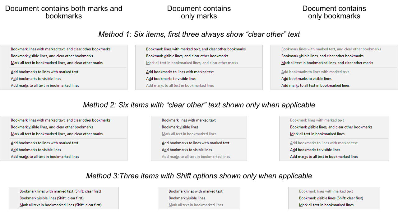

                  @astewart77, @guy038 and anyone else who cares to comment:
                  As noted, I still didn’t get the Synchronize marks and bookmarks sub-menu right in version 0.7.1. I am interested if you have any preference among these three possibilities:
                  or if you would suggest anything else?
                  As elsewhere, right-click would be equivalent to Shift+click.
                  • guy038G Offline
                    Hi, @coises, @astewart77 and All,
                    Ah,…, personally, I’m voting for the Methiod 3 as we are already used to the Shift behaviour. In addition, it remains only three items in the menu which appears more clear !
                    This is coherent with the Mark selected text (Shift: clear first) and Mark shown text (Shift: clear first) options, in the Tools menu !
                    astewart77A 1 Reply Last reply Reply Quote 1
                    • astewart77A Offline
                      astewart77 @guy038
                      I also vote for Method 3.
                      Method 2 has too much text changing from use to use. For me, the only advantage to Method 1 is being a bit easier to automate with AutoHotkey.
