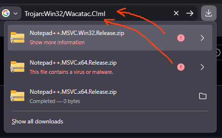

                      • xomxX Offline
                        xomx @minneyb-unix
                        @minneyb-unix
                        Maybe an antivirus or similar problem.
                        Yesterday, I had some false-positives even while trying to download N++ GitHub artifacts. I checked these "notepad++.exe"s via VirusTotal and these were flagged (only by the MS own Defender engine). Now it’s ok, so I’d try again.
