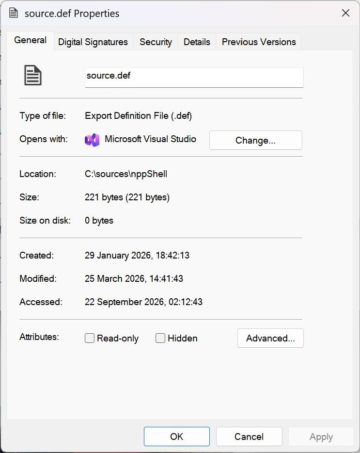

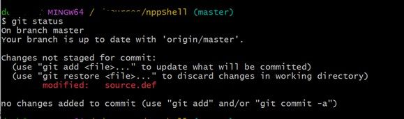

            • donhoD Online
              donho @xomx
              @xomx
              But I see that there is a significant change in the NppShell.dll export table:
              previous v8.9.8:
              Here’s the old build machine’s state:
              Explanation:
              Before switching to the new build machine, I worked on the old one and modified only source.def, as an attempt to fix something (I don’t remember what). NppShell.dll was compiled with that modification, and a signed Notepad++ installer was built for testing.
              I guess the modification didn’t fix the issue, so it was given up - but I forgot to revert the change, and it was never committed either. The modified NppShell.dll binary remained, forgotten, and end up included in v8.9.4 through v8.9.8, until v8.9.8.1 RC, which is build by a new laptop - where, of course, the modification is not present.
              Hence the different export tables between 2 DLLs.
