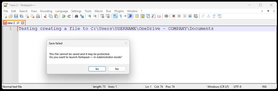

                      Scenario: Company computer, Windows 11 24H2 OS build 26100.9106.
                      I can´t save files to C:\Users\USERNAME\OneDrive - COMPANY\Documents after updating - worked before without any problems with older versions.
                      Error popup: “This file cannot be saved and it may be protected. Do you want to launch Notead++ in Administrator mode?” (see screenshot below)
                      Windows Security kicks in saying “Protected folder access blocked” - blocked by “Controlled folder access”.
                      What works:
                      I can use standard Notepad to save files to that location.
                      From notepad++ I can save to location C:\Users\USERNAME\OneDrive - COMPANY\Desktop.
                      Does Notepad 8.9.8 needs to be allowed in Windows on protected folders?

                        1. Your issue doesn’t belong to this thread.
                        2. In this case, Windows already told you all you need to know - most likely your company set that restriction via a domain policy for this specific folder in question, so you must go to the Windows Settings > Privacy & security > Windows Security > Virus & threat protection > Ransomware protection > Manage ransomware protection, and set the notepad++.exe app to be allowed there.
                        Maybe your previous N++ version was older than v8.8.7, where the N++ digital signature changed (new certificate).
                        What works:
                        Yes. All the Microsoft own binaries (digitally signed by MS) are allowed by default.
