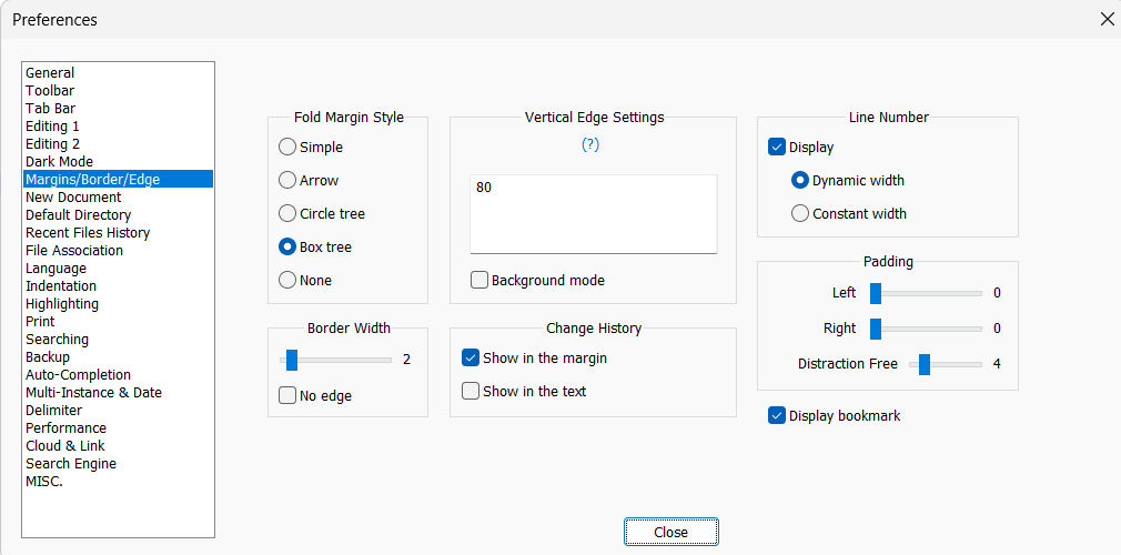

      The Problem: Currently, “Word Wrap” always wraps at the right window border. If my monitor is wide and the window is maximized, the text stretches across the whole screen. I have already set the “Vertical Edge” to 80, but this is just a visual line and doesn’t force the text to wrap there.

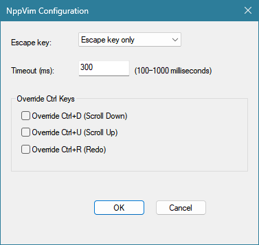

            @h-jangra Bild1.png I apologize, but I can’t find a way to set “:set tw=60 and :wrap or gq” in “NppVim”. I’m not a very experienced user; perhaps I’m missing some basic knowledge.
            h-jangraH 2 Replies Last reply Reply Quote 0

              • h-jangraH
                h-jangra @Thorsten Heuer
                @Thorsten-Heuer
                You can set vertical edge though but then wrap will not work according to that.
                • Settings → Preferences → Margins/Border/Edge
                • Enable Vertical Edge
                • Set it to 80
