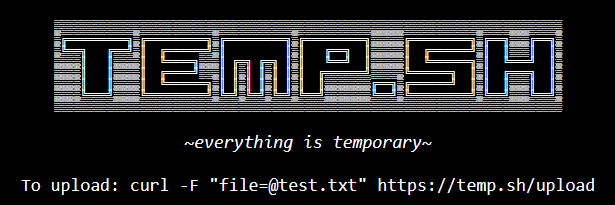

                t e m p . s h seems to be a kind of non-permanent storage, anyone can use it:
                Notepad++ doesn’t distribute/use curl.exe binary, it uses the curl-library functionality via “C:\Program Files\Notepad++\updater\libcurl.dll” for the N++ updater GUP.exe. And of course N++ never uses such an anonymous storage place.

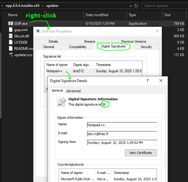

                Also you should check the digital signatures of your N++ binaries like:
