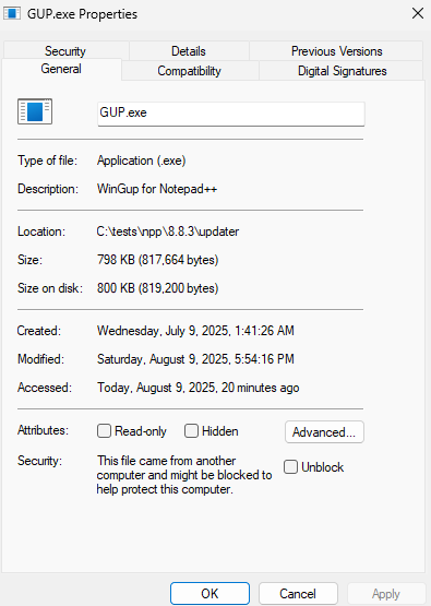

                            It looks like 8.8.2 is the last version that allows a portable version to use the plugin admin to install plugins, or am I the only one having this problem? With the newer versions you still see the dialog that Npp needs to be restarted but the restart or installation of the plugin does not take place.
                            • PeterJonesP Online
                              PeterJones @Ekopalypse
                              @Ekopalypse said in Notepad++ v8.8.4 Release Candidate:
                              I concur. I saw it yesterday with DSpellCheck on 8.8.3, but thought it was just that one plugin, and didn’t look into it more deeply. I confirmed today with 8.8.3 portable and 8.8.4-RC portable that I cannot get DSpellCheck or ConfigUpdater or CollectionInterface plugins to install through Plugins Admin. (And confirmed that v8.8.2 portable is able to install plugins using Plugins Admin)
                              Looks like a regression in v8.8.3 that wasn’t noticed.
                              • EkopalypseE Offline
                                Ekopalypse @PeterJones
                                its blocked
                                unblocking it solves it.
                                PeterJonesP donhoD 2 Replies Last reply Reply Quote 4

                                  Confirmed.
                                  For future readers: you can also unblock the zipfile before unzipping, then none of the executables will be marked as “blocked” when they are extracted.

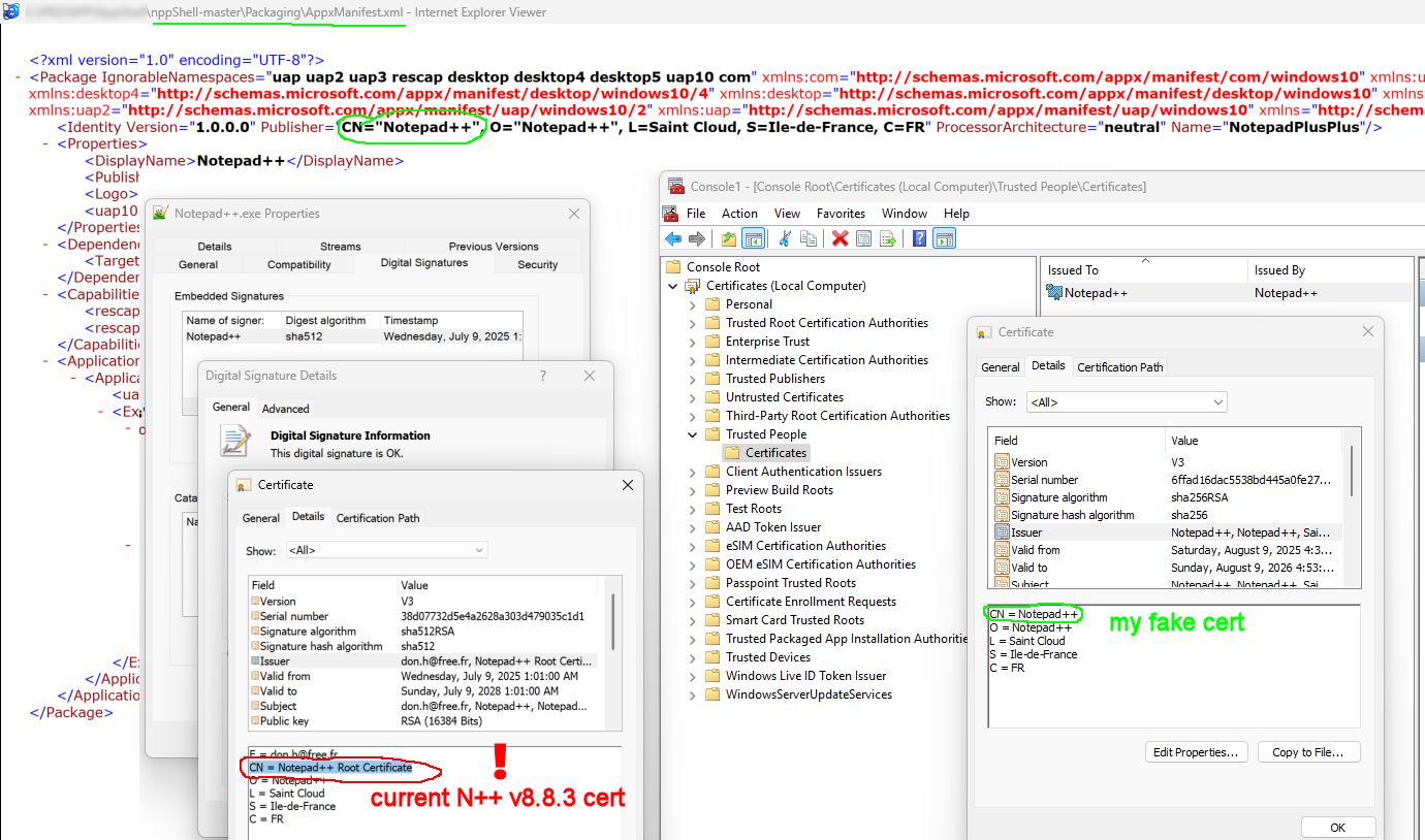

                                    Probably because of:
                                    • donhoD Offline
                                      donho @xomx
                                      @xomx
                                      It should match certificate’s Subject, not Issuer. (the issuer of the old certificate was DigiCert).
                                      I’ve checked your “home-mde” certificate comes with NppShell.dll (Thank you BTW), the content of both issuer and subject is identical.
                                      So with the new self-signed certificate, we need to add E=don.h@free.fr, at the begining.
                                      However, I still have signing problem:
                                      SignTool Error: An unexpected internal error has occurred.
                                      Error information: "Error: SignerSign() failed." (-2147024885/0x8007000b)
                                      Could you pass me your command to sign NppShell.MSIX please?
                                            PeterJones @donho
                                            @donho said in Notepad++ v8.8.4 Release Candidate:
                                            Is it due to its signature from the self-signed certificate?
                                            No, it’s the Mark of the Web that browsers add when you download a zip or exe. For a normal exe, when you run it if it has the MotW, Windows will just ask you if you agree it’s safe… but because the gup.exe wasn’t run from the GUI but from inside Notepad++, the OS apparently doesn’t ask you, so N++ just cannot spawn the gup.exe.
