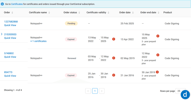

      Please note that the 8.8.2 RC binaries are not signed due to the expiration of Notepad++ code signing certificate issued by DigiCert.
      As a result, the updater for both plugins & Notepad++ itself will not function - I will adjust the security mechanism to restore the functionality, and will post 8.8.2 RC2 here ASAP.
      Edit: the security mechanism has been switched from the certificate check to SHA256 check. The updater & plugin manager will work in 8.8.2 RC2
      In order to renew the code signing certificate, I also have to renew the trademark (which, unfortunately, has expired as well). The trademark is currently under examination and listed as pending. I’ve contacted DigiCert validation team to ask whether it’s possible to issue the certificate to “Notepad++” while the trademark is still pending.
      However, since they also require Notepad++ to be a recognized business entity, we’ll most likely proceed without code signing - at least for this version. :(
      Edit: An announcement has been made to notify users about the situation of upcoming release, and to ask for help in obtaining a certificate:
      https://notepad-plus-plus.org/news/8.8.2-available-in-1-week-without-certificate/

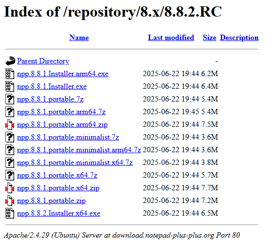

          PeterJones @donho
          @donho said in Notepad++ v8.8.2 Release Candidate:
          Notepad++ release candidate 8.8.2 is available here:
          http://download.notepad-plus-plus.org/repository/8.x/8.8.2.RC/
          The names of nearly all the files are wrong (still saying 8.8.1)

            • donhoD
              donho @PeterJones
              I forgot to rebuild x86 & arm64 Notepad++, hence the wrong version value.
              It’s fixed now.

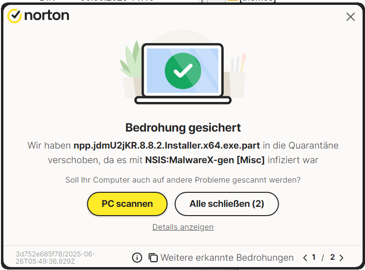

                    In such a case be prepared for an increase of AV false positives (which is unfortunate because it will also bring an increase of the risk of the app being compromised somehow (remember e.g. the CIA special ed…)).
                    So please do not trigger such a version for an auto-update!
                    This opens a door e.g. for a MITM attack. Doublecheck especially the downloaded & updated plugins. If only one of the plugins’ dl-sites will get compromised…
                    Did you consider the @Ekopalypse SignPath proposal?
                    I understand that it wouldn’t be ideal, and the cert will not bear the name “Notepad++”, but there would be the integration directly into the GitHub…

                            @xomx
                            Yes, unfortunately we have to face to this situation.

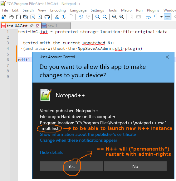

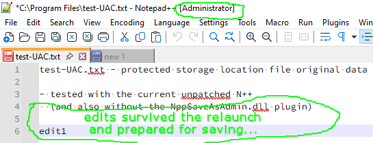

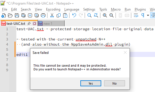

                                    1. Add feature to set read-only attribute on file so user can toggle (set/remove) read-only attribute of a file.
                                    Just fixed one (probably long standing) related issue:
                                    fix toggleReadOnlyFlagFromFileAttributes when invalid file attribute(s) or insufficient user rights #16733
                                    (for STR just create with admin-rights e.g. C:\Program Files\test-RO.txt file and set its R/O-attribute, then open it as a non-admin in N++ and try to toggle (in older N++ use the “Clear Read-Only Flag” menu item) that read-only file attribute, then check it in Explorer or simply Alt-Tab from/to N++ and see that the tab R/O-state is back as the file read-only attribute removing failed due to insufficient rights…)

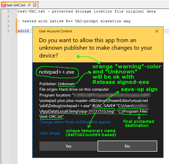

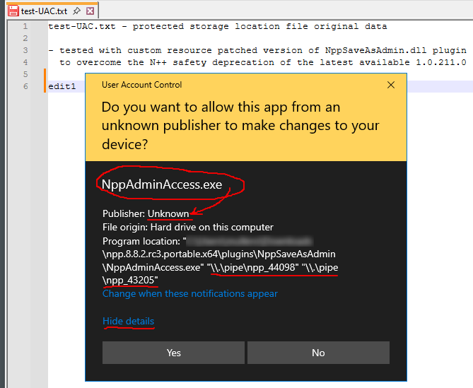

                                        Just FYI - I have in progress (so far so good, I’m already using it, it just needs to be tested more) a native N++ replacement for the deprecated NppSaveAsAdminPlugin. My concept used there will allow an easy addition of another N++ ops requiring the UAC-prompt elevation. That’s why I left this comment in my above fix when the SetFileAttributes failed - // probably the ERROR_ACCESS_DENIED (5) (TODO: UAC-prompt candidate).
                                        One more thing - I don’t think I would be the only one here who would offer to share the costs of getting the new certificate so that you don’t have to finance it only yourself. Just say so if needed.
                                        donhoD 1 Reply Last reply Reply Quote 6
