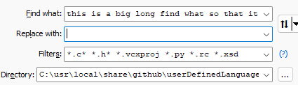

                                          PeterJones @fml2
                                          @fml2 said in Replace in Files / "Directory" field scrolls right when clicked:
                                          Upd2: I’ve played with it a little bit more. If the text is long enough the the displayed parts when scrolled to the left and to the right are completely different. It seems that the text radically changes. Very confusing.

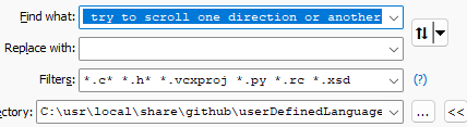

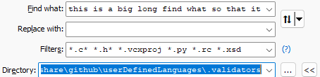

                                          Do you mean if you have a long piece of text in the combobox, like a23456789 b23456789 c23456789 d23456789 e23456789 f23456789 g23456789 h23456789 i23456789 j23456789 k23456789 l23456789 m23456789 n23456789 o23456789 p23456789 q23456789 r23456789 s23456789 t23456789 u23456789 v23456789 w23456789 x23456789 y23456789 z23456789, that when it’s not selected, you get something starting at a23456789, like
                                          04f42fe0-6171-4ada-91ee-e9af682c1d52-image.png … and when you click, so it selects, you see the end of the string, which ends with z23456789, like a8ea3807-e9a4-4aba-a6fa-9957fc8c291e-image.png ?
                                          Why is that confusing to you? That is exactly the behavior described above, so no more “confusing” than all the previous examples. This behavior is exactly the behavior which has been used for decades in Windows. I am sorry you don’t like standard Windows behavior, but the N++ developer is not going to fix Windows for you – and changing the behavior of this combobox, just so that it matches your expectations would severely confuse anyone who is used to this scrolling in every normal combobox designed with standard win32 controls that they use
                                          The text doesn’t change at all. What is visible changes, and that was already explained above. Still not confusing.

                                          If I hit tab to move to the Replace field, it does behave differently than was seen in Notepad++ or the notepad.exe SaveAs: when it unhighlights, it does not scroll back left. If I click in the FIND, then manually scroll to the left, then tab out of the FIND
                                          … then tab back into it, it goes back to scrolled all the way right:
                                          … so the select-all–then–scroll-right behavior is still identical to what we’ve already explained.
                                          So what I just showed is that when leaving that particular combobox, there is a difference in behavior compared to a normal combobox: but that can easily be explained by the fact that the combo-box is not the standard Win32 combobox control, but some custom GUI element (which is obvious by the big X there, which isn’t available in other comboboxes) – so, claiming that some huge Microsoft application like Excel or Visual Studio has comboboxes that behave differently actually proves the point, not makes things more confusing: MS had to actually write a separate GUI element not available in the main win32 API – despite the fact that they are Microsoft, and literally are the ones who wrote the public combobox interface, and thus know everything about how it can and cannot function – for form controls to be able to get the behavior you want. If MS couldn’t make the standard combobox do what you want, and had to write a separate one, then there’s no way the Notepad++ could make a standard combobox do what you are asking for… I doubt very much that the Notepad++ developer is interested in the effort to create his own combobox code (a large undertaking), when there is an existing built-in win32 API combobox which does 100% of what he wants it to do, and 95% of what you want, except when entering/exiting the combobox.
