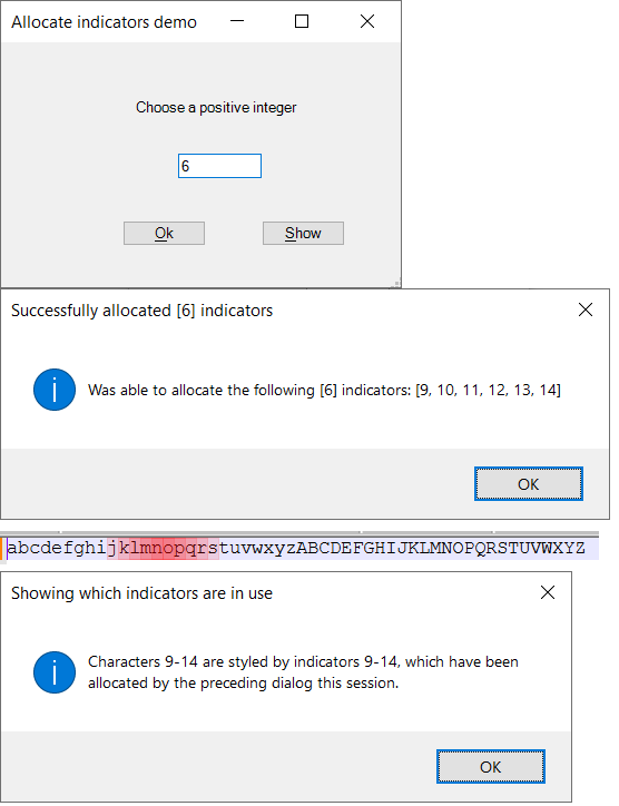

                                      If you don’t mind, I’d like to proceed with the “Indicators” approach, but then I need to understand the AllocateIndicators() method, and it looks really not simple: the provided example launches that method and as a result, a list of indicators seems to be linked with some individual characters, present in the text.
                                      I have done the following modifications to the example:
                                      for (int ii = firstIndicator; ii <= lastIndicator; ii++)
                                          Npp.editor.SetIndicatorCurrent(ii);
                                          Npp.editor.IndicSetFore(ii, new Colour(255, 0, 0)); // Colour RED
                                          Npp.editor.IndicSetStyle(ii, IndicatorStyle.FULLBOX); // Use full rectangle
                                          Npp.editor.IndicatorFillRange(ii, 5); // Not one but five characters long
                                      The result is the following:
                                      Can anybody explain me why the mentioned indicators get linked to the 9th, the 10th, … up to the 14th character? How can I change that and link those indicators to other characters, words, lines, …?
                                      EkopalypseE Mark OlsonM 2 Replies Last reply Reply Quote 0
                                        Ekopalypse @scampsd
                                        @scampsd said in How to create a C# plugin?:
                                        You have used the IDs as the starting position.
                                        SCI_INDICATORFILLRANGE(position start, position lengthFill)
                                        S 1 Reply Last reply Reply Quote 2
                                        • Mark OlsonM
                                          Mark Olson @scampsd
                                          @scampsd
                                          So the purpose of AllocateIndicators is to tell Notepad++ that you want to use a certain number of indicators. Based on how many indicators you requested, Notepad++ tells you which ones you can use (that’s the out int[] parameter). These are reserved for you for the rest of the session.
                                          Once you have the indicators, you customize their appearance using methods like IndicSetStyle and IndicSetFore. You can do this once at startup; once you’ve customized the style it stays that way for the rest of the session.
                                          To style a given region of a document with an indicator, use SetIndicatorCurrent and IndicatorFillRange.
                                          To find all the regions of a document that are styled with a given indicator, use IndicatorStart, IndicatorEnd, and IndicatorValueAt as shown in this example from JsonTools.
