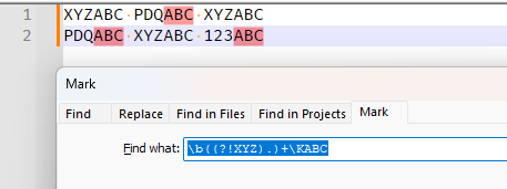

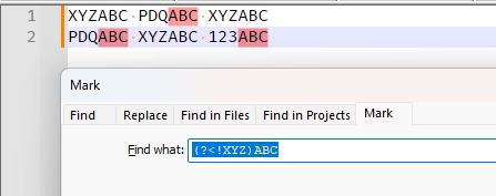

                                Looking again at how you misunderstand everything, I think I see what you did wrong: you originally had XYZ in a negative lookbehind, followed by ABC in the normal match, which was trying to mean “anything but XYZ can come before ABC”.
                                But when you converted to \K syntax, you tried to look for XYZ before ABC, which is the exact opposite.
                                What you need to do is come up with a way of saying “match any text that is not XYZ, then reset the match, then really match ABC”. Unfortunately, with complicated “not XYZ”, I personally don’t know how to express that syntax in all situations. Here’s an example with the literal XYZ and ABC:
