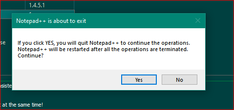

              I can understand your point about upon having a popup appear when the user tries closing the dialog box, alerting them that their changes won’t take effect until NPP is rebooted, so you’re putting the responsibility on to the user…which by the way, is counter to the way the Plugin Admin itself does things.
              It does the reboot, the same as @PeterJones plugin does, which is what I would expect when I’m required to reboot after completion, also just like Windows own update process requires. This might be the only change needed for the reboot procedure, but other than that, for a rough first version, it’s fine for me…I read directions. Sometimes not as well as I should, but I do read them. :-)
