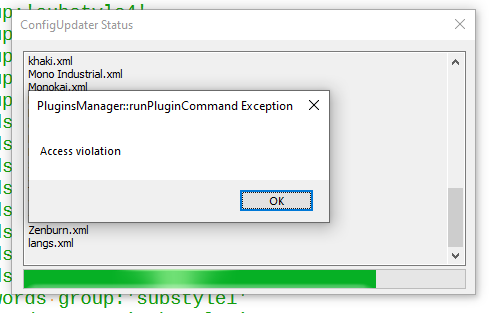

        I am on Windows 10. With my ControlledAutoIndent plugin installed (even when Enabled is not checked — in which state it should be doing nothing), I get the same result as @Lycan-Thrope.
        When I removed it and tried again, I got through the first phase and encountered the request to restart. After answering OK, waiting for relaunch and then selecting Update Config Files again, a bunch of activity occurred, and then this came up:
        This much is reproducible. I will try to investigate further. Debug info (captured before running first phase without ControlledAutoIndent):

        Edit to add: I continue to get the Access Violation in the second phase even after removing all plugins except ConfigUpdater. I will continue to search for the causes of both errors.
        Edit to add 2: The problem with ControlledAutoIndent was entirely due to a mistake in that plugin. It’s not even a “conflict,” just a straight-up error. I had no idea what would cause an “External Lexer” to be used. (The plugin keeps track of the current language so it knows what indentation rules to apply.) I made a silly mistake in the code that handles the External Lexer case, and just never hit it until now.

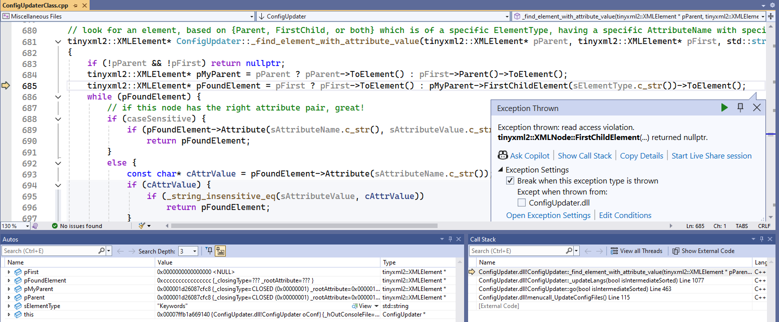

          I can give you this much concerning the apparent cause of the access violation:
          but I don’t know what to check to determine what might be leading to this condition. Quite possibly I have some very old version of one of these files, because as best I can remember, I have never manually edited any of them except (I think) shortcuts, and I’ve never bothered to try to upgrade them outside whatever the Notepad++ installer does.
            Access Violation implies that there’s a null pointer someplace. I thought I’d fixed that for all the styler/themes, but with langs.xml being the last message in the status, maybe I didn’t check properly in the langs-updater. I’ll go take a look. (However, my normal debug in Win11 and my VM+Win10 tests all worked just fine for both themes and langs, so I still cannot reproduce the problem that’s causing that, so even if I find something, I’ll have to rely on you to test if I’ve actually fixed it.
            While I am looking, could you try to do CANCEL instead of YES, and see if you still get the Access Violation at langs.xml when you are not running in Admin mode?
            update 1: I see you posted a reply just before my post: thank you for that Call Stack: I will start my search at line 1077. :-)

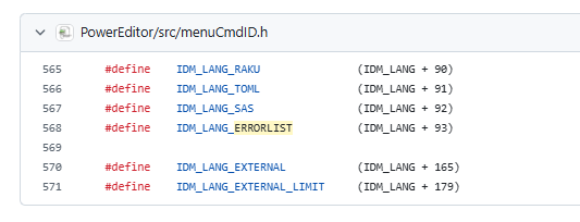

                I guarantee it is not: it is a standard Lexilla lexer. Did you update your menuCmdID.h file which defines the external lexer constants?

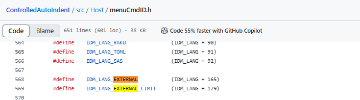

                No, it doesn’t look like you have:
                But since it’s IDM_LANG+93 vs IDM_LANG+165, and you shouldn’t be looking at the IDM, that’s not the likely culprit (though something you should still fix)

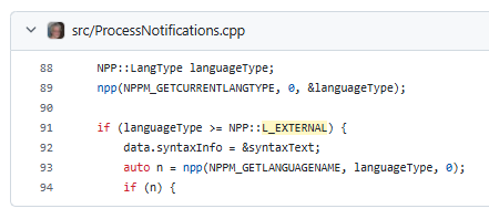

                Ah, searching for external in your plugin:
                it’s using the L_xxxx enumeration values from the Notepad_plus_msgs.h::LangType enumeration
                And that makes sense: Don chose to use whatever the “last” enumeration value happens to be for L_EXTERNAL, which means that every time a new built-in language is added, all plugin authors who compare vs L_EXTERNAL must update Notepad_plus_msgs.h whenever N++ does, otherwise their comparison will be off for anyone using one of the newer lexers in the most recent N++.
                So definitely update menuCmdID.h and Notepad_plus_msgs.h, and then that comparison should not be true, and it won’t go into that section of code erroneously.

                  Thank you. It appears (since of course updates could always happen without a plugin being updated) that I’ll need to find a way to determine what is an external lexer at run time (not just what would have been an external lexer when I compiled the plugin).
