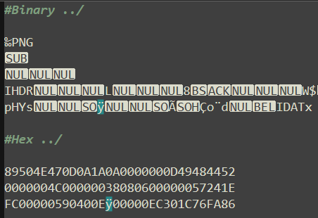

      Example Of The ASCII to HEX Issue I am Currently Experiencing in NP++:
      Encoding=UTF-8
      StringDataType=Image/Binary
      TotalBytes=10
      UseCase: The manual editing of the dimensions sector in the image binary allows for the creation of CTF challenges. Manual BOM manipulation allows for forced cropping and the concealment of color-data in the rest of the image. It can also be used to create pixelated patterns for unraveling. Notepad++ has met all these requirements for me so far. So I am pretty impressed at what I can get away with in various image formats.
      THIS EXAMPLE :
      Binary: GIF89a NUL NUL
      ASCII -> Hex: GIF89a20002000
      Bytes: 1-6 , Header
      Bytes: 7-10 , Dimensions
      The above ASCII to Hex conversion is 100% correct and was performed using the ASCII->Hex converter Ver4.3 by Don Ho which utilizes NppConverter.dll
      However this converter does not convert ‘ÿ’ to ‘FF’ for some reason. I therefore requested help on the Notepad++ forum and a py script was suggested to help with the ‘ÿ’ to ‘FF’ issue. The script worked successfully, but unfortunately landed up converting NUL bytes ‘00’ to spaces ‘20’.
      This is not helpful due to the fact that a space in ASCII is represented by the value ‘32’ (Hex ‘20’).
      So when it comes to image dimensions as in the GIF example above 20 00 20 00 , indicates a 32x32 pixel image.
      NOTE: Using a space ‘20’ to replace a NUL ‘00’ will still result in a 32x32 Gif image,
      HOWEVER, doing this to the dimension sector of a Jpeg will result in a 32x32px becoming a 8244x8224px image! Because the Big-Endian byte order of the 4-byte dimension block in Jpeg will translate 20202020 as 8244x8244 instead of 32x32 as in the case with GIF.
      This is why I need the script to correctly translate NUL bytes to ‘00’ and NOT ‘20’, otherwise it will create outrageous dimensions in formats like Jpeg, Webp and PNG.
      If NppConverter.dll is actually doing it right, then why can we not replicate it in Python?
      Thanks once again.
      Lance Marchetti

              @LanceMarchetti said in Unicode 'ÿ' , problem converting to Hex 'FF':
              “NOTE: Using a space ‘20’ to replace a NUL ‘00’ will still result in a 32x32 Gif image,”
              Correction: I just noticed that the GIF file format repeats the image dimension block later on in the binary, just before the image data begins.
              So I tried using Hex 20 20 20 20 in the second dimension sector as well. The result was INDEED a 8224x8224 image!
              Changing it back to 20 00 20 00 resulted in a 32x32 image.
              Just wanted to set that straight. Thanks.

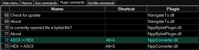

                PeterJones @LanceMarchetti
                @LanceMarchetti ,
                I was surprised that no one had suggested submitting a bug report to the Converter Plugin repo’s issue list regarding the ÿ portion, because even though most of your request is abusing a text editor to edit a non-text file, Notepad++'s Converter Plugin should be able to handle converting ÿ in a valid ANSI file (win1252 or ISO-8859-1 or similar codepage).
                But when I went looking through open and closed issues, I found it’s actually already been reported multiple times – most recently, in #11… and #11 even came with a fix in PR#16, which was rejected because Don didn’t have the Steps to Reproduce.
                Based on this conversation, I was able to come up with a minimal Steps to Reproduce, and asked Don to re-open that issue, and hopefully he will then see whether the fix #16 will work, or will come up with one that will.
                The right answer to your full query is “Notepad++ is not a binary-file editor, so you need to accept hacky suggestions”. But ÿ should be able to be handled by the Converter plugin, so I poked the ÿ issue.
                L 1 Reply Last reply Reply Quote 3
                • Alan KilbornA Online
                  I didn’t look super closely at it (due to limited interest), but I’d guess this line/block is the cause of the problem:
                  https://github.com/npp-plugins/converter/blob/37d62a54a476c935f21bdd3aa37e04f3495adcb3/source/PluginDefinition.cpp#L390
                  At least it seems suspicious. 0xFF can look a lot like -1. :-)
                    @Alan-Kilborn said in Unicode 'ÿ' , problem converting to Hex 'FF':
                    Given that PR#16 changed the getChar return value, which is what that -1 is comparing against, I’d say you’re probably right.
                      @PeterJones said in Unicode 'ÿ' , problem converting to Hex 'FF':
                      I didn’t look beyond the current code.

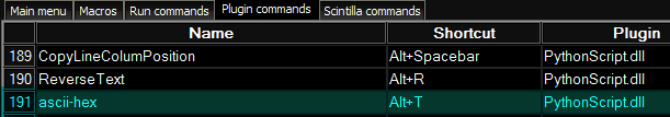

                          • Lance MarchettiL Offline
                            Lance Marchetti
                            Re: Unicode 'ÿ' – problem converting to Hex 'FF'
                            Wow, I can’t believe it’s been 2 years since I ran into this issue…anyway I finally figured out a working fix.
                            To fix the signed integer anomaly, we apply a bitwise AND mask (& 0xFF). This converts Scintilla’s negative integers back into true unsigned byte values (0 to 255) before string formatting. The entire conversion happens entirely in memory and replaces the target range in a single, atomic undo action.
                            How to Use:
                            Open a binary file, highlight the bytes you want to convert, then run the script. All ÿ and NUL bytes will successfully be converted.

                            # -*- coding: utf-8 -*-
                            # Notepad++ PythonScript: Convert selected bytes to hex, skip 0xFF (ÿ) and 0x00 (NUL). Substite with FF and 00 on second pass.
                            from Npp import *
                            def main():
                                editor.beginUndoAction()
                                try:
                                    start = editor.getSelectionStart()
                                    end = editor.getSelectionEnd()
                                    if start == end:
                                        return
                                    hex_parts = []
                                    for pos in range(start, end):
                                        raw_b = editor.getCharAt(pos)
                                        b = raw_b & 0xFF  # Keep the unsigned 0-255 byte conversion
                                        if b == 0xFF:
                                            # Direct conversion: No more placeholder strings needed!
                                            hex_parts.append("FF")
                                        else:
                                            # Flawless 2-digit Hex formatting for NUL (00) and other bytes
                                            hex_parts.append("%02X" % b)
                                    # Write the finalized, pure hex block directly to the document
                                    editor.setTargetStart(start)
                                    editor.setTargetEnd(end)
                                    editor.replaceTarget(''.join(hex_parts))
                                finally:
                                    editor.endUndoAction()
                            if __name__ == '__main__':
                                main()
