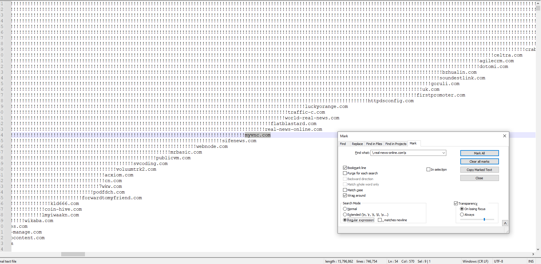

          Thank you. everything is ok, I need to add more than one domine to the Find what:
          as you can see
          this is the code:
          \.real-news-online.com, myvnc.com, 1example.com, 2example.com\s
          is this the correct method?
          How can I do this?
          Mohammad Al ThobitiM PeterJonesP 3 Replies Last reply Reply Quote 0

              .example.com|.example2.com|.example3.com\s
              OK
              Mohammad Al ThobitiM 1 Reply Last reply Reply Quote 0

                    PeterJones @Mohammad Al Thobiti
                    @Mohammad-Al-Thobiti said in I would like to group all similar domains, not by alphabet.:
                    How can I do this?
                    At some point, you need to take the lessons you’ve been taught through the dozens of regexes that people have handed you throughout this discussion, and try to figure it out yourself.
                    Useful References
                    • Please Read Before Posting
                    • Template for Search/Replace Questions
                    • Formatting Forum Posts
                    • Notepad++ Online User Manual: Searching/Regex
                    • FAQ: Where to find other regular expressions (regex) documentation
                    Please note: This Community Forum is not a data transformation service; you should not expect to be able to always say “I have data like X and want it to look like Y” and have us do all the work for you. If you are new to the Forum, and new to regular expressions, we will often give help on the first one or two data-transformation questions, especially if they are well-asked and you show a willingness to learn; and we will point you to the documentation where you can learn how to do the data transformations for yourself in the future. But if you repeatedly ask us to do your work for you, you will find that the patience of usually-helpful Community members wears thin. The best way to learn regular expressions is by experimenting with them yourself, and getting a feel for how they work; having us spoon-feed you the answers without you putting in the effort doesn’t help you in the long term and is uninteresting and annoying for us.
                    Mohammad Al ThobitiM 1 Reply Last reply Reply Quote 1
