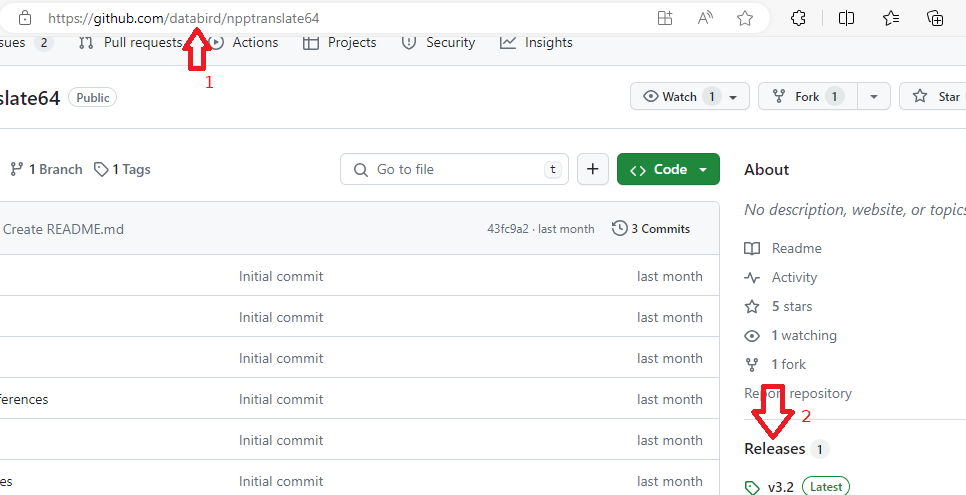

                    There is a DLL file on GitHub for npptranslate64, if you follow my instructions.
                    1. You searched “GitHub” for “npptranslate64” and found github.com/databird/npptranslate64 . which is the one with “databird” in its name, so good job so far, you found the right URL, even though you didn’t see “databird” even when you pasted that URL.
                    2. I then said “follow the ‘releases’ link”:
                      so click on that link.
                    3. That page, in the most recent release (at the top) has a DLL link.
                    Olek KsasiO 1 Reply Last reply Reply Quote 0

                                        If you choose not to use the 32bit Notepad++, then that original “Translate Plugin” isn’t available for you. (However, if you want to use 64bit Notepad++ most of the time, and just use 32bit Notepad++ for the Translation Plugin, then you could download a “portable” copy of the 32bit Notepad++ of the most recent version using the official downloads page, and unzip that portable 32bit, and use that portable copy to install the old Translate Plugin and see how it works. (Warning: it’s possible that the translation service that Translate Plugin links to costs money; I haven’t investigated, but most translation services do.)
                                        However, as @databird announced in February of this year, there is a 64bit translation plugin available under the search terms described in that reply, with more-full installation instructions in the replies immediately below – but unfortunately, it requires paying for the translation service. in general, automated translation is not free (even Google translate won’t let you access their free translation service from some other application; you can enter text manually, but if you want an API so it can be automated from some other tool like Notepad++, you’d have to pay for it.) But I believe that the original 32bit Translate Plugin also requires payment (though I’m not sure), so I don’t think the 64bit plugin is any different to the 32bit plugin, in that regard (again, I could be mistaken).
                                        The third is to use a script in the PythonScript plugin, as described in the subsequent discussion. So the steps would be
