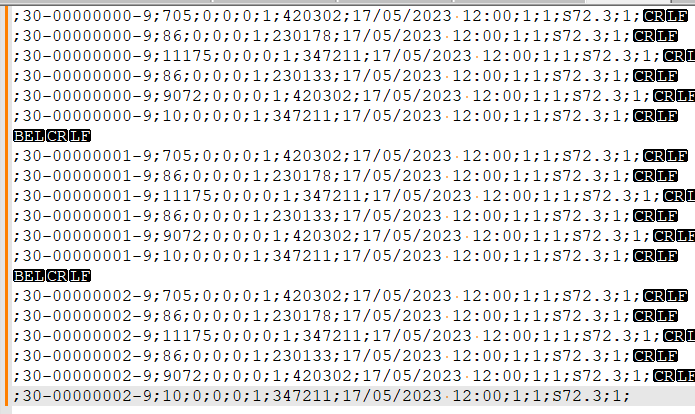

      I need to do when they are equal after the seventh row is to eliminate one of the two rows
      @Adriano said in Help duplicate files:
      It is not allowed to modify the lines or the order of the lines.

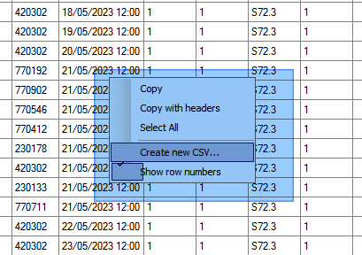

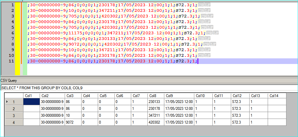

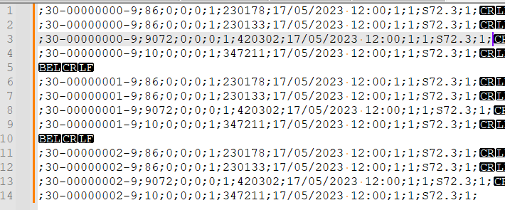

      Can you install and use a new Plugin? If it is allowed, then download CsvQuery and execute with it the following SQLLight query:
      SELECT * FROM THIS GROUP BY COL8, COL9
      You might need to modify the names of Col8 and Col9 to mach your specific case.
      The results are shown in the following screenshot:
      After that, you can right click on the CsvQuery table, create a new csv file with the results that will be:
      ;30-00000000-9;86;0;0;0;1;230133;17/05/2023 12:00;1;1;S72.3;1;
      ;30-00000000-9;86;0;0;0;1;230178;17/05/2023 12:00;1;1;S72.3;1;
      ;30-00000000-9;10;0;0;0;1;347211;17/05/2023 12:00;1;1;S72.3;1;
      ;30-00000000-9;9072;0;0;0;1;420302;17/05/2023 12:00;1;1;S72.3;1;
      and now you can copy and past them back to the original file, if you need to modify the original one or if you want you can simply save the new one as a separated file.

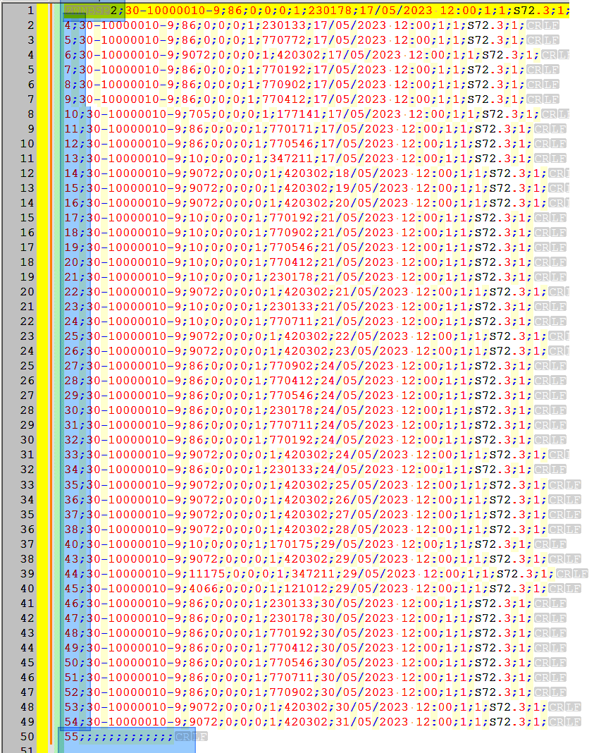

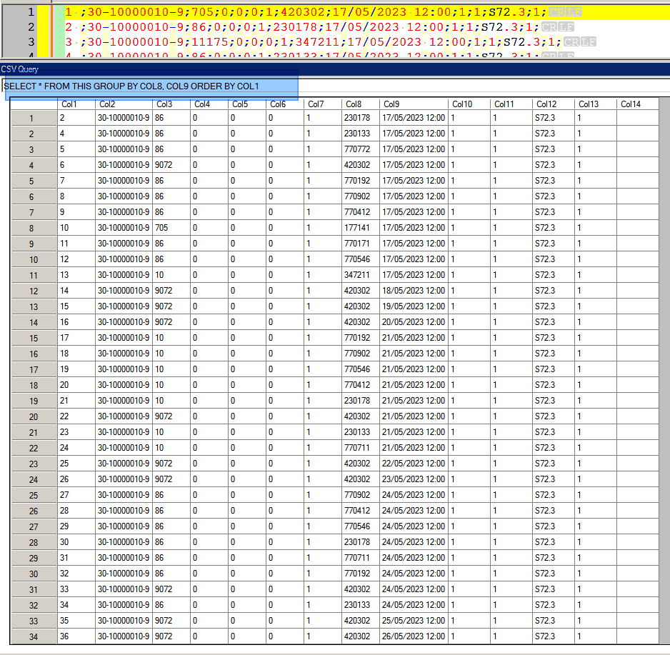

        • AdrianoA Offline
          Adriano
          @guy038 @Paul-Wormer @mkupper @Mark-Olson @PeterJones @wonkawilly

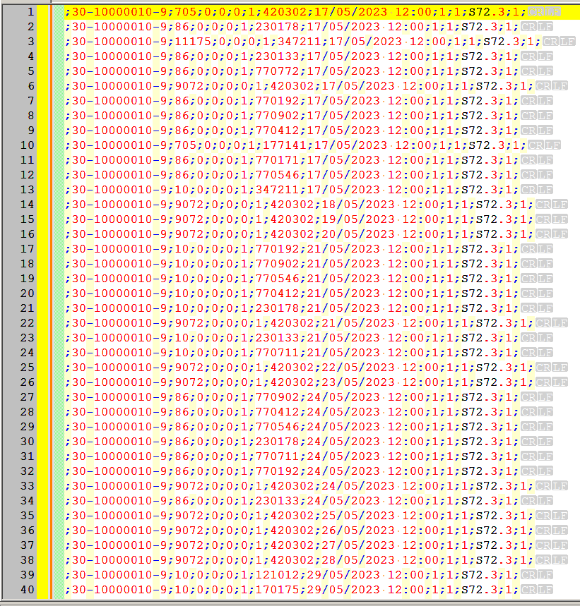

          Thank you all for your help, here is a complete summary of the report, only the REL_P to DIA_ part is used.
          From that list you should find the duplicates.

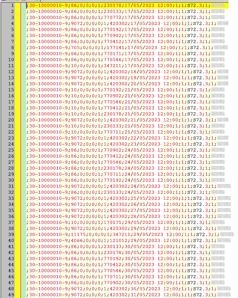

            I found that while I was copying my earlier regexes into here, I made some mistakes (I probably accidentally grabbed intermediate copies of the regex rather than the final, as I fixed problems along the way. sorry).
            After fixing those mistakes, I still had to tweak a couple things, because your new data had exceptions that weren’t covered by your original data, so some of the regex were matching too many of the lines. (This would have been prevented if you’d actually posted your big list – in a plain-text/code block like I do below – originally, rather than giving an abbreviated list.)
            So here are the steps from my list above that need to change to work with your new data.
            1. same as above
            2. FIND = (?-s)(^\d+☺)(?=.*?((?<=;)[0-9]+.;([0-9]+(/[0-9]+)+)).*$)
              REPLACE = ☺$2☺$1
              Example resulting line: ☺420302;17/05/2023☺07☺;30-10000010-9;705;0;0;0;1;420302;17/05/2023 12:00;1;1;S72.3;1;
            3. same as above
            4. FIND = (?-s)^(☺.*?)(☺\d+☺.*\R)(\1.*\R)+
              REPLACE = $1$2
            5. FIND = (?-s)^☺[0-9]+;([0-9]+(/[0-9]+)+)☺
              REPLACE = empty the replacement box (replace with nothing)
            6. same as above
              7 same as above
            With using that exact sequence, I took your data from your most recent post, and deleted 5 lines that had duplicates of the 121012;29/05/2023, 347211;17/05/2023, 347211;29/05/2023, and 420302;17/05/2023 rows. I believe that’s what you wanted. If not, sorry. It’s the best I can or will do for you.

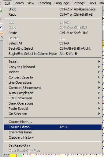

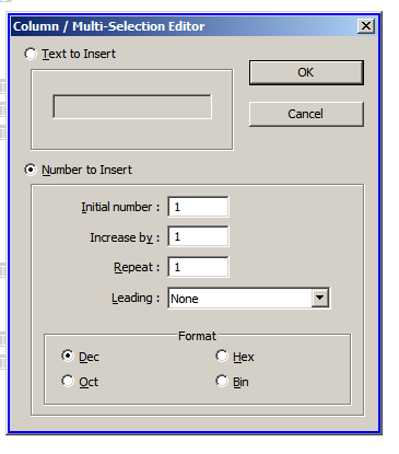

                      • Then, add, at least, 20 space characters at the end of the first line
                      • Run the Edit > Column Editor... option ( Alt + C )
                        • Choose the Number to Insert option
                        • Type in the value 1 for the Initial Number, Increase by and Repeat options
                        • Use the default space option as Leading chars as well as the Dec option
                        • Click on the OK buton
                        • Remove any unnecessary numbering at the very end of the file

                          Hi, @adriano,
                          I’ve just remarked your post where you add a real INPUT file ! So, if we placed the concerned part, between the REL_P and DIA_ boundaries, below, in a new tab :

                              • First with Ctrl+Home goto the very first char of the very first row;
                              • Then go to Menu > Column editor and add a progressive number to all rows
                              • Open the Csv Query panel and write and execute the following query

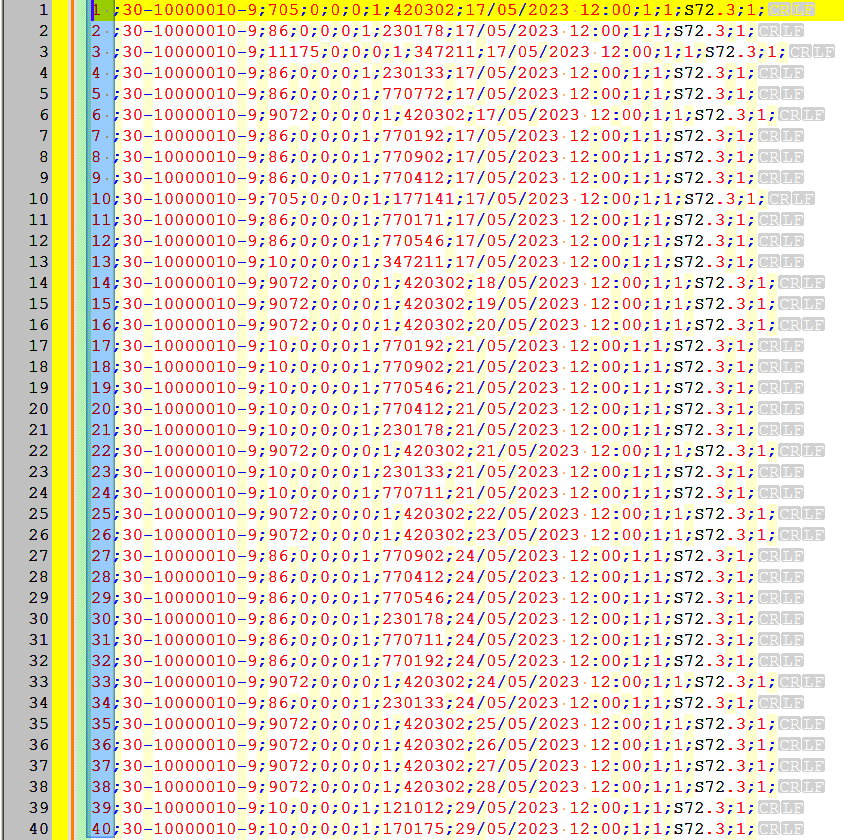

                              SELECT * FROM THIS GROUP BY COL8, COL9 ORDER BY COL1
                              • The query will return the following results
                              • Create new csv file using Right Mouse Button menu from CSV Query plugin window
                              • And set the options you like from the next little dialog that the procedure will show
                              • After the creation of the new csv, clean up the unwanted progressive number and other unwanted chars that in case might be present into the new csv file keeping the first “;”
                              • This will be the clean result, and you are almost ready
                              • Now delete from the original file the rows after the seventh (no screenshot for this step on)
                              • Delete from the new file the first rows until you match the seventh (that is yet into the first file) should be first 5 rows to delete from the new csv
                              • Copy the resulting rows still remaining from the new file and paste them into the old one.
                              The following should be the result:

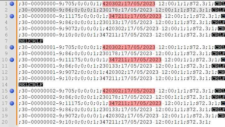

                              • guy038G Offline
                                Hi, @adriano, @wonkawilly, @paul-wormer and All,
                                I’m sorry, @wonkawilly, but it seems that your final OUTPUT text still contains 2 duplicates lines, according to the @adriano’s logic !
                                The concerned lines, from your final text, are :
                                • Lines 1 and 6
                                ;30-10000010-9;705;0;0;0;1;420302;17/05/2023 12:00;1;1;S72.3;1;      discriminate zone  =  420302;17/05/2023 12:00
                                ;30-10000010-9;9072;0;0;0;1;420302;17/05/2023 12:00;1;1;S72.3;1;     discriminate zone  =  420302;17/05/2023 12:00
                                • Lines 3 and 13
                                ;30-10000010-9;11175;0;0;0;1;347211;17/05/2023 12:00;1;1;S72.3;1;    discriminate zone  =  347211;17/05/2023 12:00
                                ;30-10000010-9;10;0;0;0;1;347211;17/05/2023 12:00;1;1;S72.3;1;       discriminate zone  =  347211;17/05/2023 12:00
                                P.S. :
                                In my solution, the duplicate lines 6 and 3 are correctly deleted !
                                wonkawillyW 1 Reply Last reply Reply Quote 0
