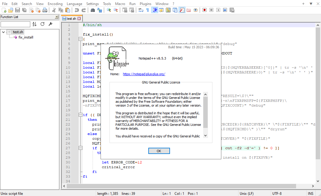

      Greetings. I recently noticed that the Function List for some of my Shell-formatted scripts is incomplete. I write my scripts using a fairly consistent format when it comes to my functions. For some reason, this function refuses to show up in the list even after saving, closing NPP and restarting. I have several other functions that all show up in the list. I didn’t find any previous posts that were related to Shell-formatted functions, and I didn’t see anything in the bash.xml function list template that looked like it might cause it to be excluded. Any help is appreciated. Debug info included below the function code.
      Thanks!

        Michael Vincent @greg-michael
        @greg-michael said in Function List incomplete:
        I suspect it’s not this function, but rather what else is in your script that is causing the issue:
        comments, newlines, mismatched braces … ?

        • greg-michaelG
          greg-michael @Michael Vincent
          @Michael-Vincent When I run the script, there are no errors regarding mismatched/unmatched parentheses, braces, brackets, etc. It also makes me wonder why the other functions would show up in my functions list, but not this one. I’ll see about yanking the whole thing out, saving it, closing NPP, and then adding it back in. Might be some trial and error, but maybe there’s something there that shouldn’t be that I just am not seeing.
          • greg-michaelG
            @Michael-Vincent said in Function List incomplete:
            OK, so this is really weird. I simply cut the entire function from the script, moved it above the function that immediately precedes it, saved it, and the function list automatically added it.
            Testing further, I moved the other function elsewhere in the script, saved it, and the function that immediately follows that function now no longer shows up in the functions list.
            Isolating the function in question, there is no issue with it displaying in the functions list. There must be something at the end of the function that is causing the issue.
            A bunch of commenting, saving, uncommenting, saving, etc. brings it down to this single line:
            LINKCMDOUT="$( nexec -i -l ${DSSVR} "${(e)BASELINKCMD} 2>/dev/null ; echo -e \"RESULT=\$?\" ; sleep 5 ; ${FINDCMD} /opt -maxdepth 1 -type l -ilname '*mqm*' -ls 2>/dev/null" )"
            It doesn’t like the semi-colons.

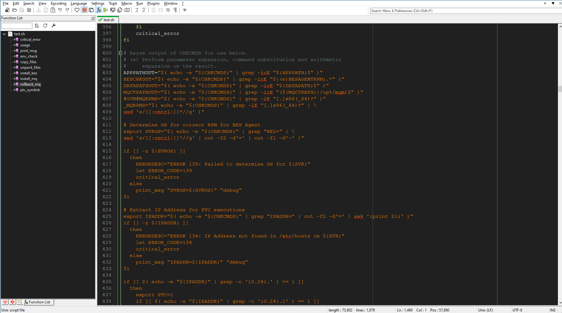

            • greg-michaelG
              greg-michael
              Should this be logged as a bug or some sort of defect? Anyone have any suggestions on how to modify the bash.xml functionList file to accommodate the use of semi-colons?
              I suspect that this part of the function node is causing the issue:
              [^{;]*?\{                                           # no semi-colon until start of body
              The line in question is within an if-then-else body, and there are lines elsewhere within my script inside other functions that are displayed in the functions list that use inline semi-colons in the same way that are not exhibiting this behavior within NP++.
              Worst case scenario, it’s a minor inconvenience. Just hoping that someone a little more familiar with this code might have an idea.
              Thanks!
                “RESULT=$?”
                For my testing, it seems to be the escaped double-quotes in the expression you highlight:
                ... \"RESULT=\$?\" ...
                If I change that part to:
                ... RESULT=\$? ...
                All my functions show. If I have the escaped double-quotes in, then the function following that line does not appear in the function list.
                greg-michaelG 1 Reply Last reply Reply Quote 0
                                      @greg-michael
                                      I think something went wrong with the cut and pastes, from line 403 on it lexes as a string:

                                      • MAPJe71M
                                        MAPJe71
                                        The following two lines in the ptc_symlink-function are the problem:
                                        LINKCMDOUT="$( nexec -i -l ${DSSVR} "${(e)BASELINKCMD} 2>/dev/null \
                                        When you escape two additional double-quotes, refresh or save the file, the fix_install-function is listed
                                        e.g.
                                        LINKCMDOUT="$( nexec -i -l ${DSSVR} \"${(e)BASELINKCMD} 2>/dev/null \
                                        ; echo -e \"RESULT=\$?\" ; sleep 5 ; ${FINDCMD} /opt -maxdepth 1 -type l -ilname '*mqm*' -ls 2>/dev/null\" )"
                                        greg-michaelG 1 Reply Last reply Reply Quote 1
                                        • greg-michaelG
                                          greg-michael @MAPJe71
                                          @MAPJe71 Interesting… I have a few other lines throughout the script that utilize the same syntax structure I believe. Why wouldn’t those functions be affected the same way? For example, lines #370-#375, lines #814-#815, lines #1271-#1272, line #1321, line #1333, and lines #1384-#1385.
                                          For what it’s worth, I’ll explain what the line is doing from an application perspective.
                                          This script runs in BMC’s TrueSight Server Automation as an NSH script. NSH is based on the ZShell. The syntax of the command is such that the subshell command “nexec” is doing a remote shell execution on a target server to create a symbolic link, echo the result with a “RESULT=” prefix, waits 5 seconds, and then does a find command to list out the contents of the /opt path looking for symbolic links.
                                          The output looks similar to this:
                                          RESULT=0
                                          nexec -i -l algebs.ds.cpr.ca "/bin/find /opt -type l -ilname '*mqm*' -ls"
                                                867      0 lrwxrwxrwx   1  mqm      mqm            21 Nov  9  2021 /opt/mqm/bin -> /usr/mqm/MQSV9202/bin
                                          Thanks!
                                          MAPJe71M 1 Reply Last reply Reply Quote 0
                                          • greg-michaelG
                                            @greg-michael
                                            I went back and copied that section of pasted code separately from the forum post into a new Shell-formatted document in NP++ and it looked normal. Did you possibly miss a starting quote in the copy/paste from the forum into your NP++?
