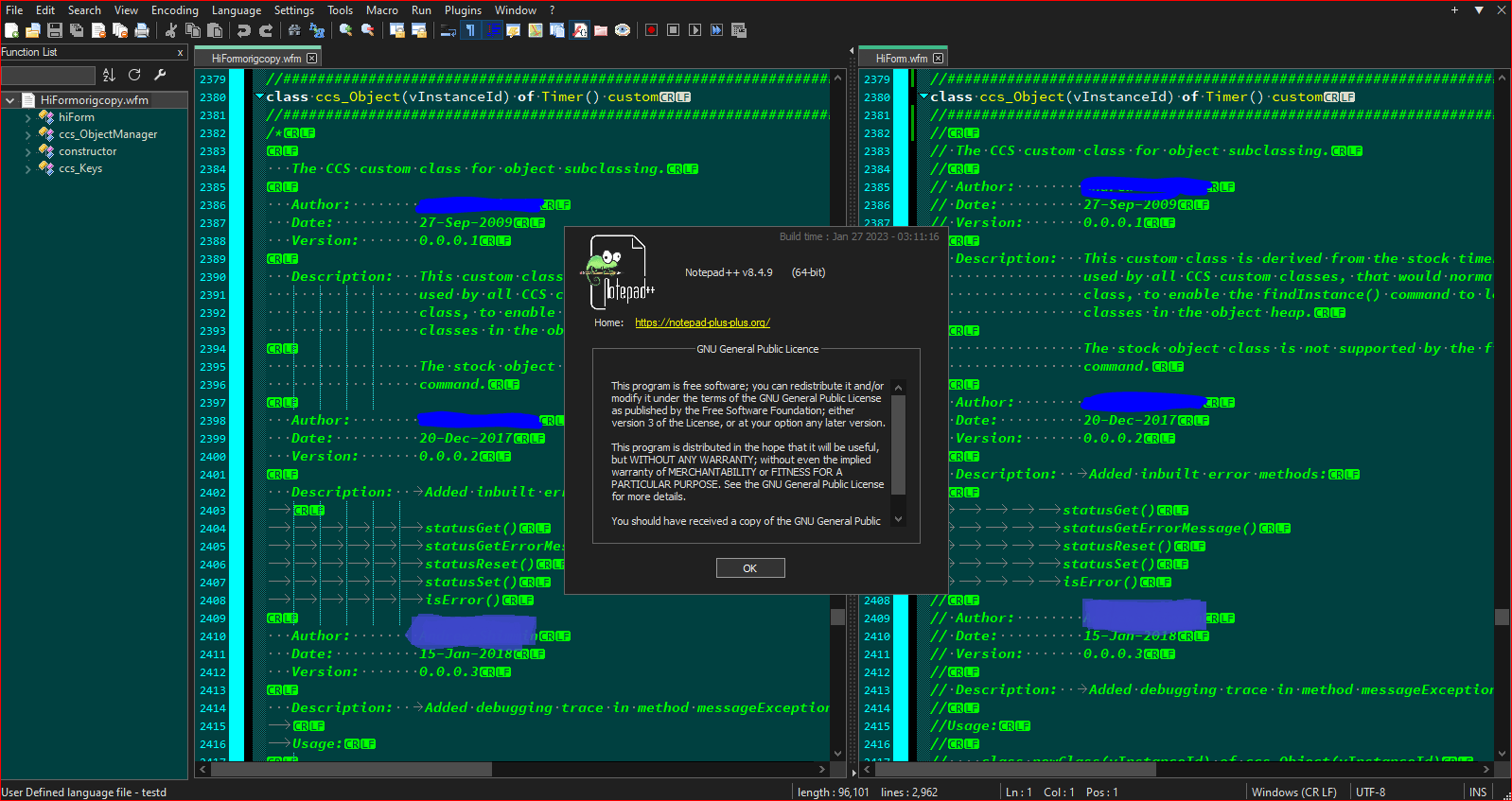

      @Lycan-Thrope said in functionList not ignoring comments:
      @mpheath ,
      Edit: Also, after checking, I want to point out that in the c.xml functionList panel file, those commentExpr options are not OR’d out either, which is why I removed the OR’s in mine.
      https://github.com/notepad-plus-plus/notepad-plus-plus/blob/f38195a0da5657f447ccc949bc77f38dba06aa61/PowerEditor/installer/functionList/c.xml#L15-L20
      Can you look again? I see | characters separating the groups in c.xml. Otherwise the patterns of the groups would be treated as 1 whole pattern to try to match that I would expect, though @dinkumoil has more experience with Function List patterns so might be able to confirm.
      I cannot test bits and pieces so am at a disadvantage to be 100% sure of my advice. I do have a custom Notepad++ build that outputs the pairs and a Python 3 script that uses the pairs to make a hta (html) file showing the matched zones. This might be useful to show the matching pairs visually with info popups like for example.
      … when I was using Mark to try and work out the regex aspect …
      The searching is done with zones pairs. A discussion about the function unit parser behaviour, though the (Class/Method/Function) mix parser uses zones though a bit different. It is not exactly like the workings of Find and Replace dialog, so take note that the later F&R use is a guide, not a 100% certainty.
      I’ll probably be submitting an issue then.
      Where is the evidence of a bug? Where are the files to reproduce the issue? Need something to focus on to find a bug. Images are nice to look at though we cannot run the function list parser on images. Suggest to get your stuff sorted here and now and exhaust all options before creating an issue.
      dinkumoilD Lycan ThropeL 2 Replies Last reply Reply Quote 3

        @mpheath said in functionList not ignoring comments:
        That’s exactly the answer I would have given. Regular expressions for matching different types of comments have to be OR’d, otherwise they would not work.
        Thumbs up, nothing more to say.
          Thanks, I was wondering why I couldn’t reproduce one of the original problems again. You were right, the c.xml file commentExpr was OR’d, but were aligned with the indentation indicators, which is why I missed them. As you’ll see from this image, it has removed even the faux class name from the list of the Original file, constructor isn’t there anymore. Nothing is there. Removing the OR, showed the issue of the missing class and why it was missing.

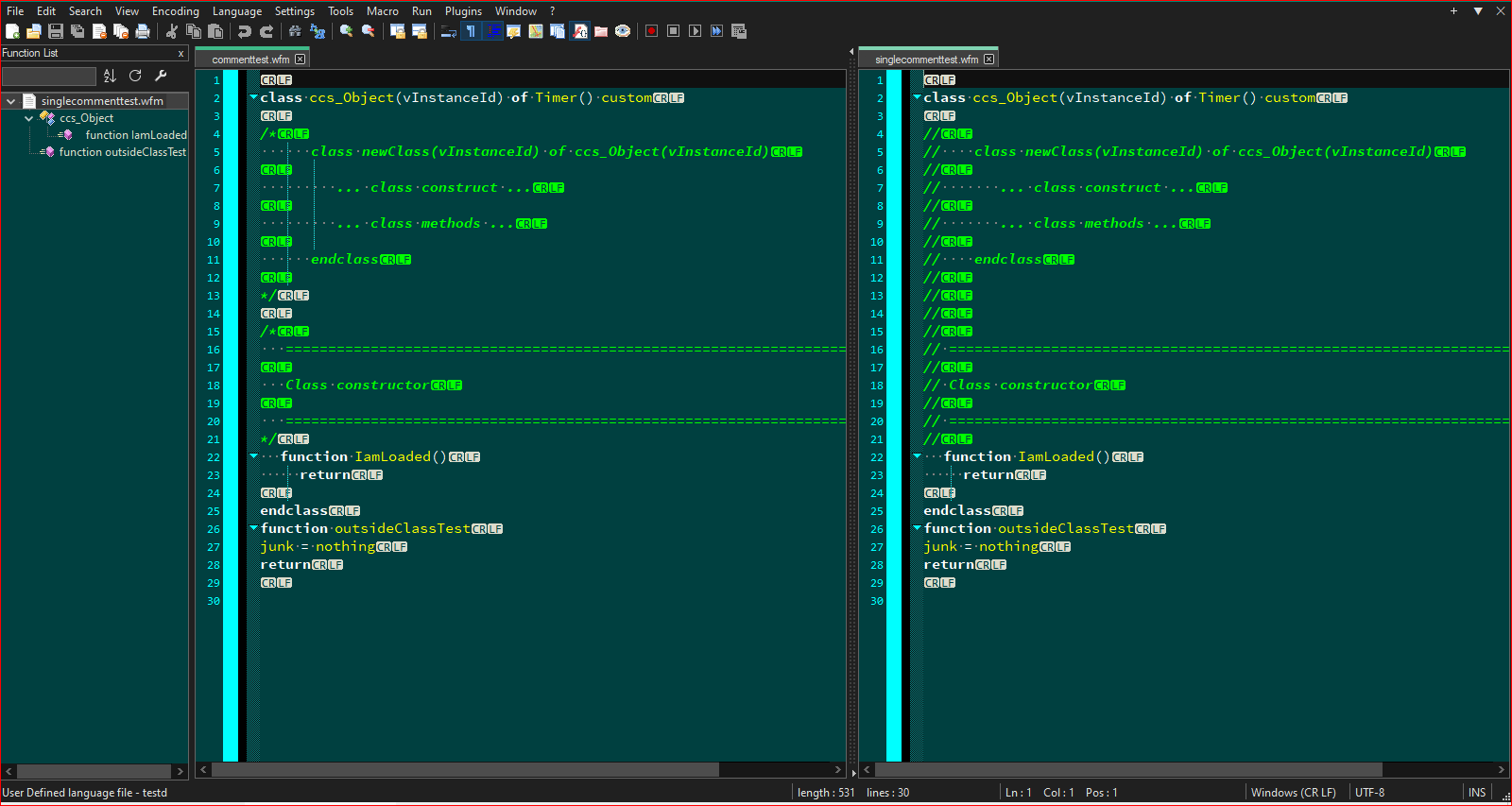

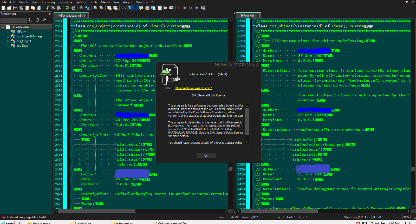

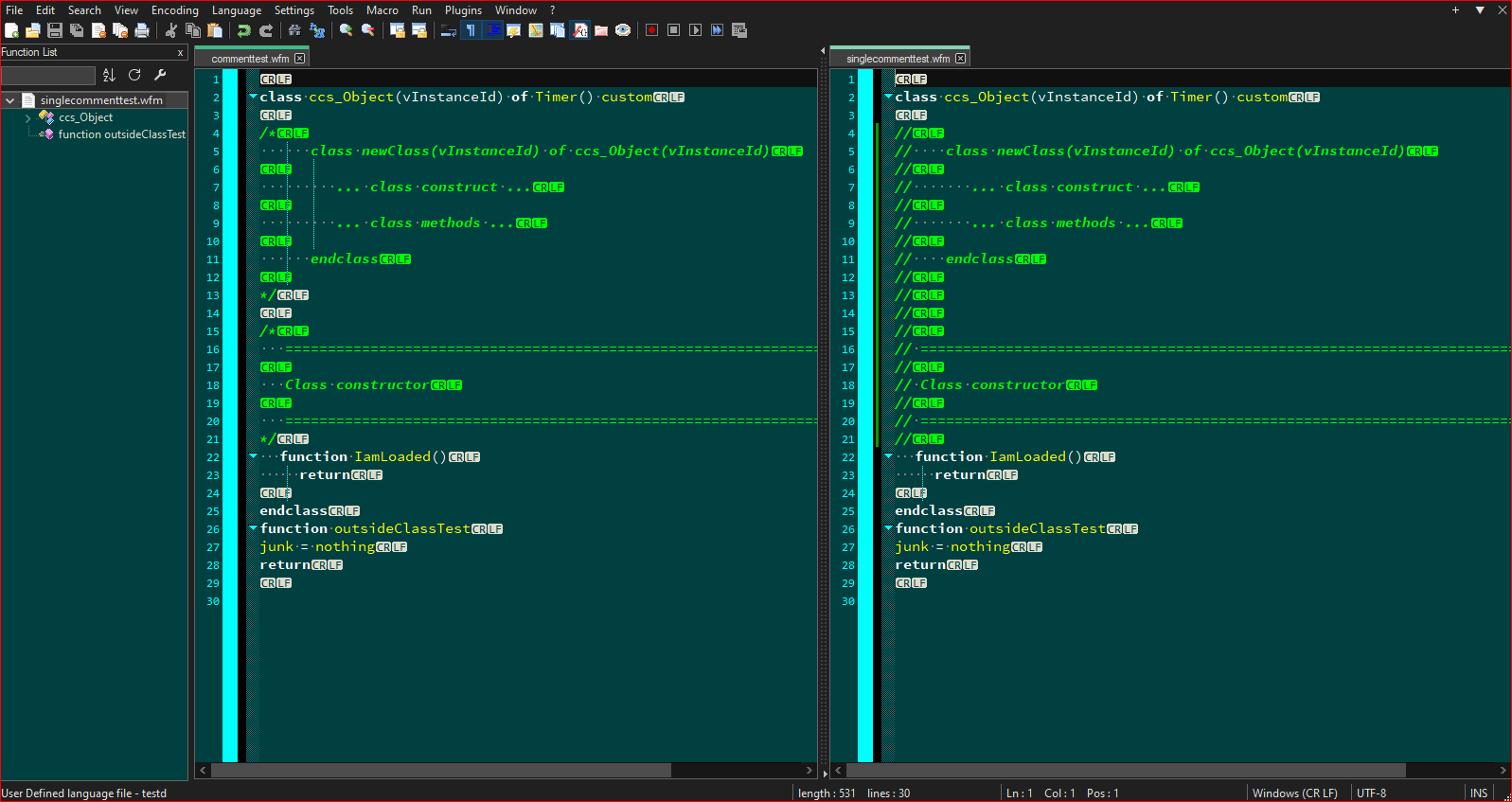

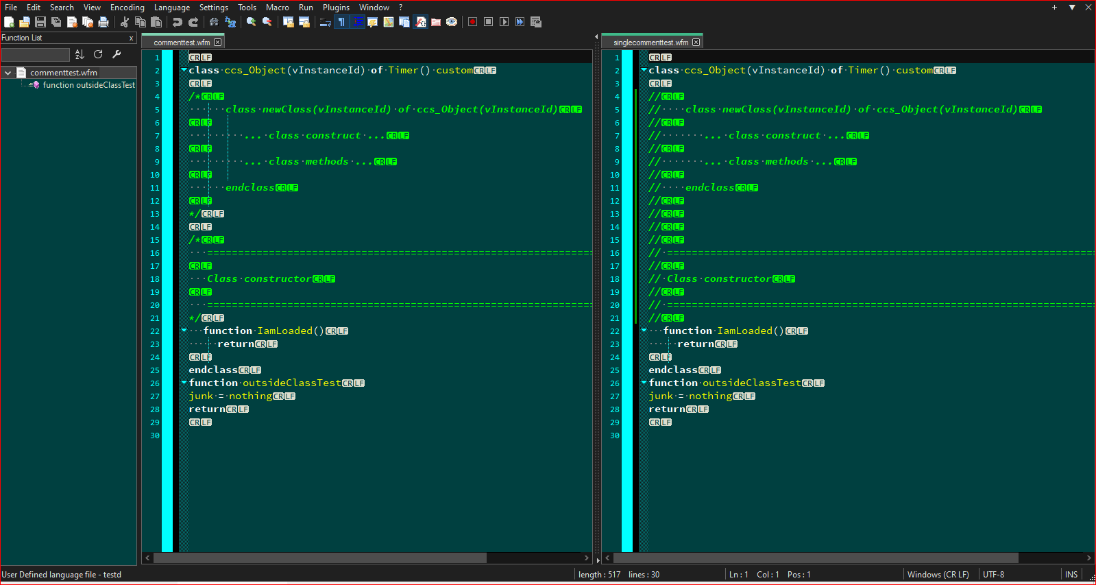

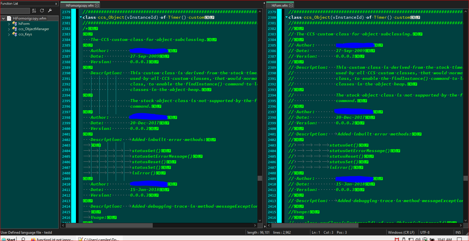

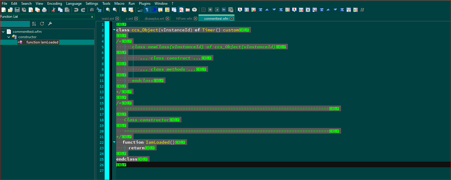

          I will be preparing these things. The images are just so I can show what I’m seeing to maybe jog anyone’s memory if, other than just @dinkumoil’s, if they’ve seen this behavior, and to show, I’m not imagining it.
          That’s why I’m posting it here first, to discuss it and to iron out any misgivings, like this one, on my end.

            @dinkumoil ,
            Here’s the code that is being used for the UDL and the functionList parser. The following sample code is modified from the above with the addition of a function outside of the class, to show the mixed parser functionality working.
            Sample:
            class ccs_Object(vInstanceId) of Timer() custom
                  class newClass(vInstanceId) of ccs_Object(vInstanceId)
                     ... class construct ...
                     ... class methods ...
                  endclass
               Class constructor
               function IamLoaded()
                  return
            endclass
            function outsideClassTest
            junk = nothing
            return

              • Lycan ThropeL
                Lycan Thrope @Lycan Thrope
                @Lycan-Thrope ,
                The result of these files, again, can be viewed with this version of the test file above. One with block comments, one with single line comments and the one with single line comments with the class expanded to view the internal function/method.
                Block Comments:
                Single Line Comments:
                And this one shows the class opened up to see the internal function/method:
                Waiting to hear your feedback.

                    Thanks for the files. This is the output of the zones…
                    commentZone: 51, 209
                    commentZone: 213, 409
                    classZone: 0, 203
                    classZone: 301, 460
                    funcZone: 462, 487
                    This is the visual (Disregard green at end as it is missing a closing span tag). The Class match is from the start of the document (pos 0) and ends at endclass (pos 203) inside the comment zone. Code within comments are invalid as a match. This class match is not within a comment zone so is a valid match as far as the parser is concerned. Making it invalid because it is partly into a comment zone would IMO lose the Class from being displayed in the functionlist panel and would be a worse result.
                    Looking at the pascal.xml function list file, I do not see patterns trying to locate the end keyword of a Class, Function or Procedure. So in testd.xml , is it necessary to match to endclass to acknowledge a Class definition?
                    Class definition:
                    I do not know the fine details of recognizing class functions from ordinary functions with the functionlist patterns so @dinkumoil may be able to help with that.
                    Greediness in the patterns seems to be a problem with the functionlist parsing so suggest to avoid using greedy patterns. The larger the match, the more vunerable it is to run into an issue like this one. Try to aim for the smallest match to achieve a successful result. I consider that @dinkumoil has achieved that with pascal.xml.
                    • Lycan ThropeL
                      Lycan Thrope @mpheath
                      @mpheath ,
                      What am I looking at there? Is that the character/caret positions?
                      To answer your question, yes, we needed to have the endclass found to close the class. That regex was giving me trouble, as you point out, trying to find only the least amount. @PeterJones , @guy038 , and a few other users here helped formulate the needed regex in that functionList parser file. We needed that to make the regex run the entire length down to the endclass so we could find and close the Class definition.
                      The dBASE Plus OOP isn’t like C++, where typically, one file = one class. We can have multiple classes defined per file, and thanks to @PeterJones , we also were able to have our objects display like functions inside a Class definition, because they are basically UI objects inside a Class…they technically are other class objects being defined inside a class. So yes, it needs to find the endclass to close one class, and find another.
                      We can’t use the OpenSymbole/CloseSymbole delimiters like C++ can. We tried putting the terms class/endclass inside those, but I suspect they are only meant for single characters as we never were able to get them to be used for identifying the open/close it needed to frame the Class definitions.
                      But, again…the endclass should be ignored, inside comments. Period. :)

                      • mpheathM
                        mpheath @Lycan Thrope
                        @Lycan-Thrope
                        Edit: Yes, they are character/caret positions, so I see and you see what I’m saying. :) The numbers are off, I suspect for some kind of whitespace offset or newline offset. I finally realized you had a link for me to follow to see that graphic. Yes…how did you produce that?
                        They are positions of start and end pairs of a match. I consider the start pos as off by 1. Produced by stdout with some debugging code that the Python script captures and processes it into html. It gives a reasonable visual of the matches, though not perfect as the missing unclosed span tag probably due to overlapping zones.
                        You can state that, though the reality is that you may need to work with the parser as it is. I could state it is the pattern that needs fixing as it trys to handle everything from class to endclass. Demands have no relevence without reason.
                        Not sure why. The pattern searches to the endclass and yet the pattern does not properly handle code in comments. Seems like an issue with the pattern as it wants to do this rather large match. To blame the parser for the greedy pattern seems unreasonable.
                        The subject is not about the C++ functionlist so is opening a new argument. I mentioned the pascal.xml which Pascal uses begin and end, though as I mentioned, the Pascal patterns do not look for the end keyword.
                        The way I see it is that the patterns need to work with the parser. The parser will probably not be changed to make up for patterns that fail to work due to being large. The maintainer IMO will not risk all the functionlist patterns in use to make you or your developer happy even if it were possible. There is a bash functionlist file issue at least 2 years old and risking the other functionlist files could be a bad option. Suggest you fix the pattern.
                        • Lycan ThropeL
                          I will have to respectfully, disagree.
                          The pattern works. It has been working. It continues to work.
                          The problem is the parser, and in particular, the commentZones code, in this instance.
                          If developers don’t comment their code, the parser is safe, but that’s not realistic, either. The simple fact is, the parser doesn’t recognize comments inside a class. It recognizes it before, or after, but not inside…particularly when those comments have actual keywords. Perhaps, you could say, it’s the Zone that is the problem, as it doesn’t recognize when something (a class in this instance) has not ended, but has comments started inside it. Multi-line comments, in this case, and it is the parsers weakness that it doesn’t realize it’s still inside a class. That’s why the classrange element has these:
                          openSymbole ="\{"
                          closeSymbole="\}"
                          And the parser makes calls like this:
                          bool FunctionParsersManager::getZonePaserParameters(TiXmlNode *classRangeParser, generic_string &mainExprStr, generic_string &openSymboleStr, generic_string &closeSymboleStr, std::vector<generic_string> &classNameExprArray, generic_string &functionExprStr, std::vector<generic_string> &functionNameExprArray)
                          It can’t possibly parse a zone, if it doesn’t know the beginning and end of it.
                          It’s because the parser doesn’t allow keywords to be used in the open and close Symbole, that having to find endclass became necessary.
                          Another way to work around this is not to put block comments inside a class, because the parser doesn’t work like a real parser. It’s a quasi-parser. That kind of encourages not commenting code, which seems like it is encouraging a bad habit that is already rampant. Either way, you can’t reasonably expect the parser to work properly if it doesn’t allow the parserLanguage.xml to define it’s open and close pattern, and that’s what this parser is doing, and so this pattern was improvised to make the parser function.
                          So please, don’t disparage the pattern. I’d like to think some really talented people created it, sans myself, right @PeterJones ? :)
                          mpheathM PeterJonesP 2 Replies Last reply Reply Quote 0
                          • mpheathM
                            @Lycan-Thrope Try changing line 91 in testd.xml
                            						  (?si:.*?^\h*endclass)           #  must match all the way to 'endclass'
                            to
                            						  (?si:.*?^\h*(?!//\h*)endclass(?!\s*\*/))           #  must match all the way to 'endclass'
                            if endclass is preceded by // or followed by */ then it is probably commented.
                            funcZone: 411, 432
                            classZone: 0, 460
                            funcZone: 462, 487
                            Instead of 2 classZones as before, now there is only 1 classZone.
                            Lycan ThropeL 3 Replies Last reply Reply Quote 3

                              • Lycan ThropeL
                                (?si:.?^\h(?!//\h*)endclass(?!\s**/))
                                1.) Thank you. It works.
                                2.) I humbly, thank you and now, see what you were referring to with regard handling the comments inside the regex…
                                I was again trying last night/this morning before I retired, to try different things like you did, but obviously don’t have the chops that I thought I had. :)
                                @PeterJones , in his follow-up message almost points out how I thought the parser worked.
                                My impression, was that when it was inside the class zone, it would would read until the endclass and if a commmentZone was encountered, it would ignore reading anything inside, regardless what was in it until it found the end of the commentZone, and then would continue on with it’s previous Zone since it did not find it’s end. In that regard, it would be like a switch, with it’s recursion, like how a function in code works (It seemed like the logical explanation) where it would stop basic operation there until it finished the commentZone, and then return to it’s previous task. Maybe, that is the way it works, but the weak point was, we’re not able to use a keyword, only a character symbol, so I can see, now, why you meant it needed to deal with comments in the regex pattern itself. My thoughts were that was why we defind the comment regex prior to the pattern searching.
                                So I accept that this was, again, user error. Mine. :)

                                  I guess I was just confused about how I was supposed to alter the regex to deal with comments, as I wasn’t sure what he meant, since he seemed to be saying I needed to stop the pattern from seeking the endclass, which we couldn’t, because otherwise the class pattern would never be recognized. I know, I tried it last night, as that’s what I thought he was referring to, and all the functions inside and out showed up, but not the classes, so I knew that endclass keyword had to stay. I’ll have to chalk this misunderstanding to my lack of experience, which, thanks to his above solution, I can be a little wiser…not much…but a little. :)
                                  • Lycan ThropeL
                                    @mpheath ,
                                    Just a futher follow up. After the initial fix worked for the example file presented, we have again found the issue rearing it’s head elsewhere, so while it temporarily fixed the issue, I feel the only real fix for this issue, will need to be the code allowing for keywords like class/endclass for the open and close demarcations that the classrange element expects for locating those zones.
                                    I’m trying to get myself up to speed somewhat in C++ so I can at least read the code with a little more knowledge and see if I can’t figure out how to find and change what I think needs to be changed and I guess do a pull request and muck it up. :)
                                    Thanks anyway, and I think this subject here will at least let people know if they find this issue in their functionList implementation of their language, if it has a mixed parser, this is a possible explanation for the problem.
                                    • Lycan ThropeL
                                      @mpheath ,
                                      After going over a lot of stuff, including reexamining the FunctionList FAQ, I have to agree with you, that at present, I may need to work with the parser, as is. I must have missed that ‘embedded comments’ section, or glossed over it, or didn’t relate it to the kind of comments we do as the example seemed to be an example of excessive use of inline ‘block’ comment style for an inline comment. That may be what threw me as regards that example in the FAQ.
                                      Moving the opening class declaration line after any block comments immediately following it, fixes the problem completely, with my recent testing. It appears, however, that as I discovered before, line comments inside a class taking up a whole line, or after code, inside a class/endclass block does indeed work as it should.
                                      So I guess until I get up to speed with C++ and take a crack at a fix for the block comments giving problems inside a class/endclass code block, block comments will have to be avoided.
                                      I do, however, feel that the simple fix for this, should be just allowing a longer string other than \{ and \} symbol characters would be a proper fix, since being able to use class and endclass in the open/close symbole elements, it would be part of the actual parser demarcation ability to know where a class starts and ends, rather than having to use regex to find all the way to the end like this regex had to do to be able to outline the structure of the class. For now, the crisis is averted until I can revisit this issue, hopefully with some C++ skills at a later date. :)
