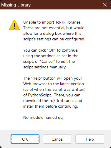

                  I’m sorry, but I’m still having trouble with exception handling; when Tk is involved, it seems to eat the exception itself instead of passing it up to Python. Some sample code:

                  This code does as I expect - so long as the exception is in the testing for Tk. Comment out import qq, let Tk create and display “My Custom Dialog Box”, and click on its “Cancel” button, and a similar traceback appears in the console - but preceded by Exception in Tkinter callback. What can I do to get these exceptions both treated the same way? (And yes, I do realize that this sample code does nothing to actually catch the exception; I wanted to be sure it wasn’t my code that was eating it.)

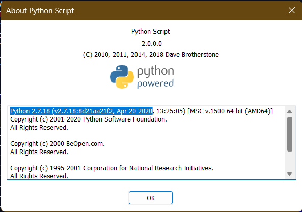

                  And on a (probably) unrelated note, why is the “Plugins Admin” version of PythonScript so old? There are probably lots of people using it that don’t realize how outdated it is. Plus, I imagine it makes it more difficult to assist users when they’re likely not using the same version that you are.
                    If I look at it, it shows the current version. Maybe you could be more specific in this question, like exactly what you see and why you think it is old?
                        You complained to us about an old version of PythonScript in Plugins Admin, but the screenshot highlights that you’re actually wondering about the old version of the Python interpreter that’s part of PythonScript Plugin.
                        PythonScript is currently developing a Python 3 version of PythonScript Plugin, which is available for download in the PythonScript repository… But since it’s a huge project, it’s still considered alpha/beta and thus not in Plugins Admin yet. But that doesn’t stop you from installing it manually.
                        Michael VincentM TBugReporterT 2 Replies Last reply Reply Quote 0
                          PythonScript 2.0 is NOT “old”. It may use a Python interpreter that is deemed “old”, but it does so for a reasonable reason. Python 2 and Python 3 differ in one huge way: How they treat strings. Python 2 doesn’t support unicode very well. Python 3 does. Because Notepad++ supports non-unicode encodings and always has, Python 2 is a great choice via PythonScript 2.0. If one isn’t going to use non-unicode encodings, then PythonScript 3.0 is probably the better choice. If the PythonScript developers figure out how to handle non-unicode encodings well in a Python 3 environment (that doesn’t like them), then PythonScript 2 could be phased out in favor of PythonScript 3.

                                      @PeterJones said in Using the PythonScript plugin to automate N++:
                                      Are you saying that infamous help site is version shaming you?
                                      Well, yeah, in at least one case where I tagged the post as python-2.7 instead of plain python - but worse than that, the question was closed by a bot that referred me right back to the answer that I was failing to understand.
                                      PythonScript 2.0.0 using Python 2.7.18 is the most recent non-beta release of the plugin.
                                      I’m aware of that - it just seems that the maintainer must be needing some help if it’s taking ~3 years to move everything to Python 3. (Unfortunately, as I explained about my Internet identity, I can’t offer much help in that regard, and there apparently aren’t many people who can.)
                                      my first web search […] brought me to this

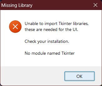

                                      Yes, I’ve been bouncing around the pages linked from that page for several days now, but I’m no closer to adapting those examples to my situation. I’m sure part of the problem is that I’ve been coding since long before “object oriented” was a thing, and I still can’t wrap my Neolithic brain around “classes” and such - but another part is that those examples all seem to want to bring the exception (in my case, it’s not an error message) to the console, and I’m specifically looking to avoid spewing all that red text in the user’s face.
                                      PythonScript […] should be able to properly throw an exception
                                      Agreed. The Python docs say that Tkinter handles exceptions very differently than regular Python, but there’s no explanation of how a Python coder needs to adapt their code to the differences. (Maybe if I keep running into these walls a bit harder, I’ll start to enjoy it more. 😵‍💫)
