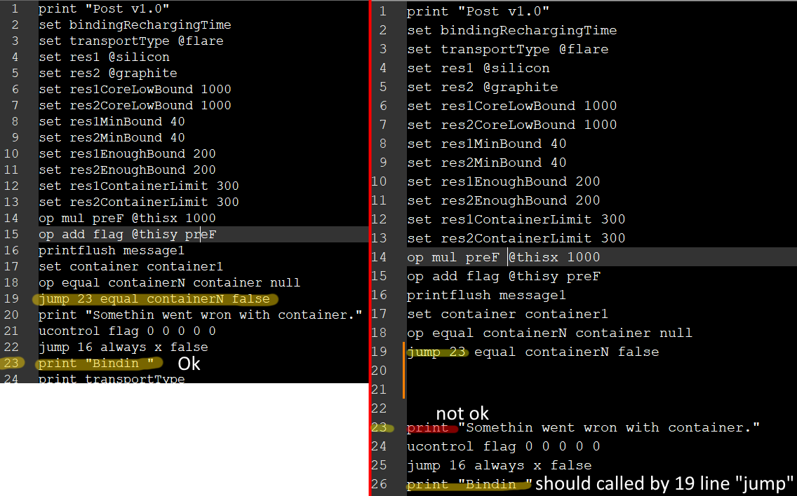

                Im programming simple script that uses “jump” to line where every line in script is counting.
                For example:
                1|print “Post v1.0”
                2| set bindingRechargingTime
                3| set transportType @flare
                4| jump 23 equal containerN false
                23| print "Bindin "
                So you can see i can easely find where jump from line 4 goes.
                But if i add some empty lines to make code more readable between 4 and 23:
                5|
                24| print "Bindin "
                the script beguns incorrect because "print "Bindin " should called instead other line.
                That’s why i want to associate notepad lines counting with that script.
                After work, of course, i should remove empty lines for correct script working.
                That’s why i want.
                Im susessfully download NppPluginTemplate but its extreemly hard to undestand how getting started to work with him. Any suggestions for that?
                Thank you very much for your help.

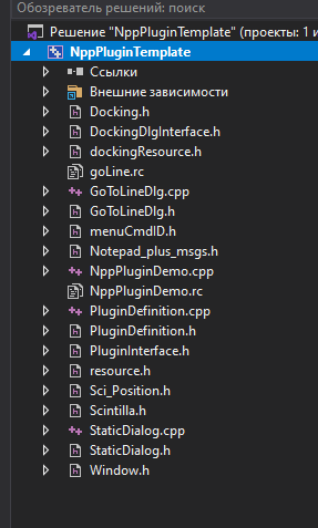

                  How to Develop A Plugin => this section of the user manual takes you through the four steps (which are also shown in the plugin template) to get to a point where you can compile a plugin. After that, you have to understand enough about programming to make the plugin actually do something useful.

                    ok i must explain it better, my bad.
                    As a left pucture it goes ok for me as programmer that easely find line that provides jump instruction using npp lines counting bar.
                    But after adding temporary empty lines for more code readability that you can see on right side picture npp bar digits increases lines count as it should. But for me it means bar digits is not now associated with code jump command, it brings to another print command because correct print now is 23. This issue hinders only me as programmer because empty lines that i added should be removed after publication.

                    I did steps stopping on 3rd step, you can see my answer upper with picture contains cppPluginTemplate. All just i need its menu on task bar swithing these bar styles and directly my function.
                    It is means that if there is not enought plugin template for me i cant create my own plugin?
                    Extreemply thanks for help supporting.
