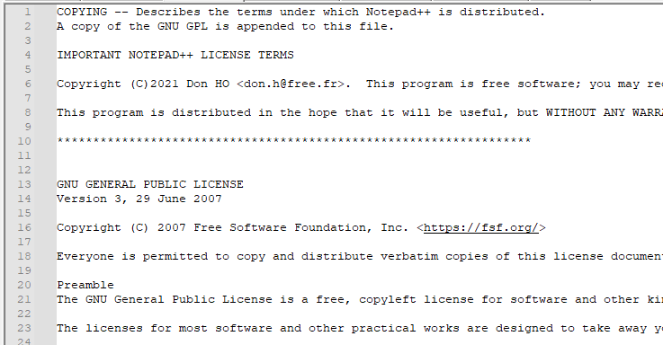

        Open N++'s license.txt file:

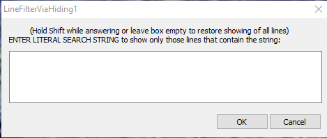

        Press Ctrl+Shift+h (if so assigned, otherwise, invoke the script from the PythonScript menu system).

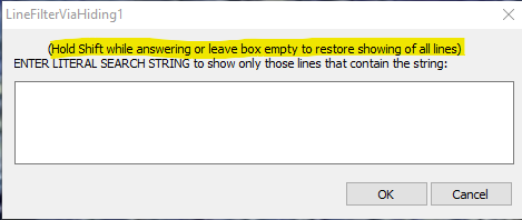

        A prompt box appears:
        Enter free in the box and press OK.

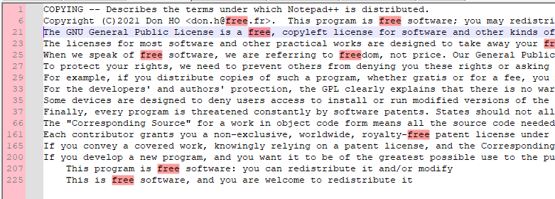

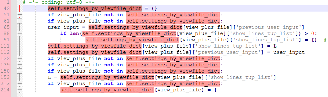

        The view will shift to something like this:
        Things to note:
        • Only lines containing the word free are shown; all other lines are hidden (except line 1, which can’t be hidden)
        • free is redmarked
        • The line-number margin is given a special color to remind you that you are in a special viewing mode (this reminder is not typically needed, but sometimes when your search results in most lines of a file being shown, it is!)

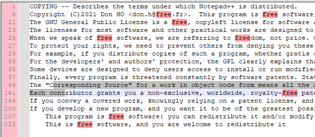

        • If you make a selection across line 66 and 161 (as shown below) and press Delete, you will be eliminating roughly 100 lines (be careful; small deletes could be large deletes)
        • If you made a large delete like that, Undo ing it can be problematic, as Notepad++ doesn’t know about the script and will reveal the previously hidden lines. The mode that the script provides is for “light editing” only; if things seem to get “out of sync”, your data is ok, just your view is bad. If you haven’t deleted lines, switching tabs and switching back will freshen the view. If you’ve done some larger deletion, just reinvoke the prompt box and re-run the logic to obtain a current look.
        • In order to return to no-filtering, in other words, showing all lines, invoke the prompt box again and either remove all text from the input area and press OK, or simply hold the Shift key down while pressing OK with the mouse (or, keyboard-only, Shift+Enter) – note the yellow text in the screenshot below. Once all lines are restored to view, the line number margin is also restored to its default coloring, indicating filtering is no longer active.

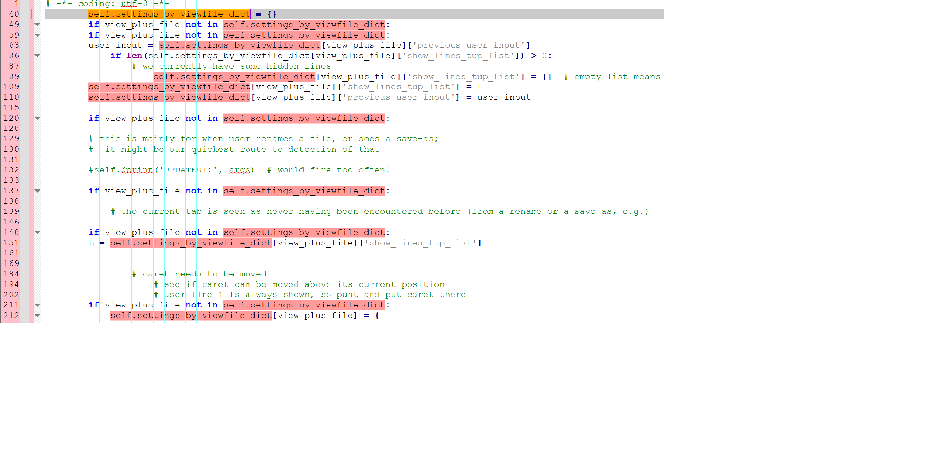

                    Alan Kilborn @Paul Wormer
                    @Paul-Wormer said in Show only lines that contain a search term:
                    The result below shows some lines that do not contain this string.
                    Hmmmm, right you are. I can obtain the same result. Curious that I didn’t see this type of thing while working on the script. :-(
                    Ok, so let’s do this:

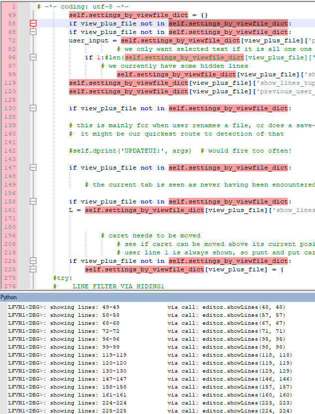

                    There’s a line in the script: self.debug = True if 0 else False. With that line as written, “debug” is off. BTW, I write that line that way so that I can change only a single character to turn debugging on or off. Let’s turn it on now, so change the 0 to a 1.
                    There are two places in the script where the PythonScript function editor.showLines() is called. In one place it is called to get all lines displayed, so right now we don’t care about that one. The one we care about is where the lines with the search string are displayed after all lines are hidden. That one looks like this in the code: editor.showLines(line_start, line_end). Find that line and put this new line after it:
                    self.dprint('showing lines: {sp1}-{ep1} \t\t\tvia call: editor.showLines({s}, {e})'.format(s=line_start, e=line_end, sp1=line_start + 1, ep1=line_end + 1))
                    After restarting N++ to pick up the changes, run the functionality again.
                    Here’s an example of what I see:
                    Notice that since we’ve turned debugging on, we now see juicy details about the script in the PythonScript console window. In mine we see the lines the script wants to show: line 49, 58, etc. (Don’t be concerned if my line numbers don’t match yours)
                    The interesting thing is, in the editor window we can see lines 138 thru 143 that don’t have the search text, but the script only turns on display of line 130 before turning on line 147! (There are some other places in the output where this oddity occurs, but lines 138-143 are the most blatantly obvious)
                    I currently don’t have an explanation for this :-( but I’m going to keep looking at it…

                      datatraveller1 @Alan Kilborn
                      @Alan-Kilborn I’ve tried you script now, too and it works well for me. Thank you for that!
                      Is it possible to do a case insensitive search? ( I suppose not yet).
                      BTW, I tried to copy all filtered lines to the clipboard but the whole file content gets copied - is this the expected behaviour?

                        datatraveller1 @Paul Wormer
                        self.settings_by_viewfile_dict
                        I think what I see is the correct result:
                        datatraveller1D 2 Replies Last reply Reply Quote 0

                            datatraveller1 @datatraveller1
                            @datatraveller1 said in Show only lines that contain a search term:
                            @Alan-Kilborn Do you know why I get the correct result if I filter for self.settings_by_viewfile_dict while Paul and you get the wrong result? :-)
                            Paul WormerP 1 Reply Last reply Reply Quote 0
                            • Paul WormerP
                              Paul Wormer @datatraveller1
                              @datatraveller1 I run the script three times in a new session:
                              1. Hide lines not containing the string
                              2. Undo it (show all lines again)
                              3. Hide lines not containing the string
                              Then: step 1 gives too many lines and step 3 is OK.
                              datatraveller1D 1 Reply Last reply Reply Quote 0
                              • datatraveller1D
                                @Paul-Wormer I still get always correct results (also after repeating steps 1-3 up to 10 times).
                                • Paul WormerP
                                  @datatraveller1 Also in a new session? That is, after closing Npp and starting it again?
                                  • datatraveller1D
                                    @Paul-Wormer Yes, always correct results.

                                      The sleep(60) gave me time to look at what’s happening and I noticed that often not all lines are hidden at the first sleep. These lines stay visible after the second sleep. The lines that stay visible are more or less random, so I get the feeling that it is a matter of timing. When I increase the length of the file by adding comments different lines stay visible. Datatraveller1 may well have a faster PC than Alan and me.
                                        Hello, @alan-kilborn, @paul-wormer, @datatraveller1 and All,
                                        Well, I finished the traditional sequence of greetings, by phone, SMS and letters. So I just tested your Python script, Alan, and here are the results of my experiments !
                                        • Personally, I never saw the case of visible lines not containing the literal string to search for. Good point !
                                        • Like you, @alan-kilborn, I used the License.txt file, which I duplicated several times and enter the lower-case word free when running the script And, as I increased the size of the test file, the waiting time to get the line margin highlighted, in salmon color, increased in parallel :
                                                           Search of the literal lower-case word 'free'
                                        Times "License.txt"             Size                  Lines       Hiding lines time
                                        license.txt ×    1            35,500 bytes            231 lines          0,4  s
                                        license.txt ×    5           177,500 bytes          1,155 lines          1,95 s
                                        license.txt ×   10           355,000 bytes          2,310 lines          3,5  s
                                        license.txt ×   50         1,775,000 bytes         11,550 lines         17    s
                                        license.txt ×  100         3,550,000,bytes         23,100 lines         34    s
                                        license.txt ×  500        17,750,000 bytes        115,500 lines        165    s
                                        license.txt × 1000        35,500,000,bytes        231,000 lines        335    s
