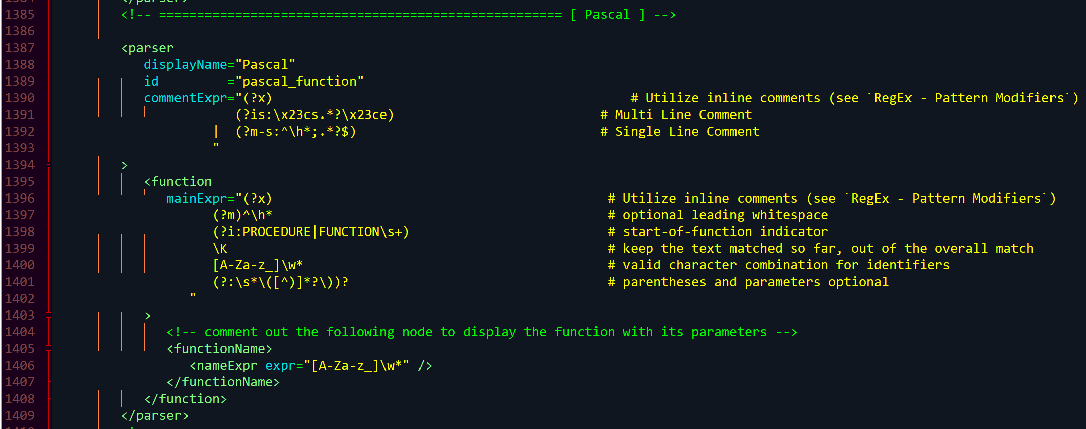

      The first one is that Pascal has Functions and Procedures, Functions return something, Procedures do not… as far as the Function List is concerned, they are both the same. I can’t figure out how to get both “Function” and “Procedure” to show up in the list.
      I can’t paste it as code here because it’s just a giant unreadable mess, but here is a screen shot of what I am trying to do:

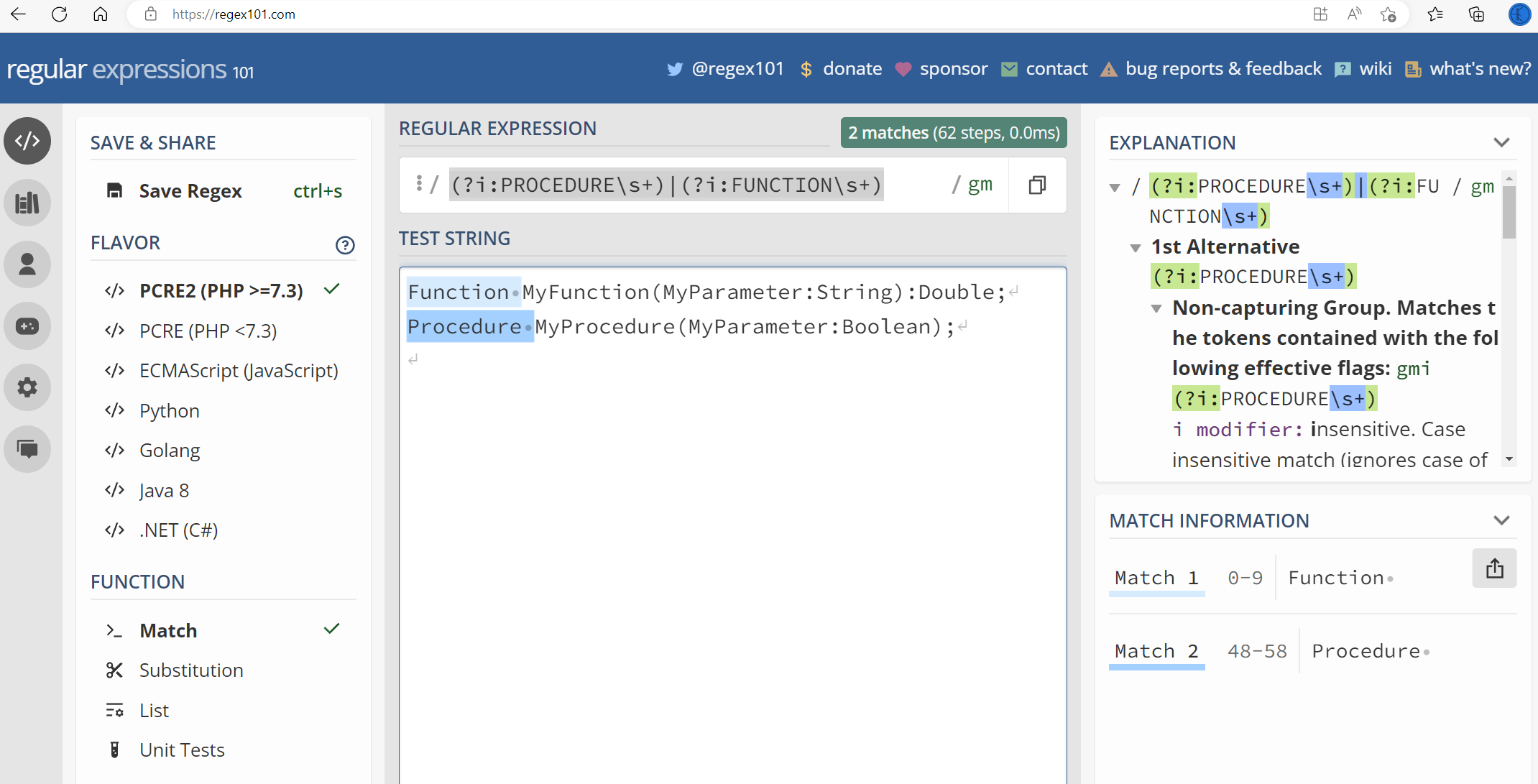

      I don’t know anything at all about Regex Expressions, but I tried an OR function in an on-line Regex helper and (?i:PROCEDURE\s+)|(?i:FUNCTION\s+) should get a hit on both Procedure and Function… but it doesn’t work, I only get whatever I put there first.

      Here’s the code just in case it looks better after I post it:
      			<association id=     "pascal_function"    langID="11"                          />
      			<!-- ===================================================== [ Pascal ] -->
      			<parser
      				displayName="Pascal"
      				id         ="pascal_function"
      				commentExpr="(?x)                                            # Utilize inline comments (see `RegEx - Pattern Modifiers`)
      								(?is:\x23cs.*?\x23ce)                            # Multi Line Comment
      							|	(?m-s:^\h*;.*?$)                                 # Single Line Comment
      				<function
      					mainExpr="(?x)                                            # Utilize inline comments (see `RegEx - Pattern Modifiers`)
      							(?m)^\h*                                            # optional leading whitespace
      							(?i:PROCEDURE|FUNCTION\s+)                          # start-of-function indicator
      							\K                                                  # keep the text matched so far, out of the overall match
      							[A-Za-z_]\w*                                        # valid character combination for identifiers
      					      (?:\s*\([^)]*?\))?                                  # parentheses and parameters optional
      					<!-- comment out the following node to display the function with its parameters -->
      					<functionName>
      						<nameExpr expr="[A-Za-z_]\w*" />
      					</functionName>
      				</function>
      			</parser>

                                  You can see things above the commented out section are duplicated. In my original test, I had some units more than 100 functions down commented out like this, so I had a lot of duplicates.
                                  If I would have commented them out with // instead, then it works fine, unfortunately I have a LOT of units and many times I would comment things out with { } just to show what was in the unit… it would be a monumental undertaking to go through and change them all.
                                  Unfortunately, my idea to make a comment out of everything between Interface and Implementation also does not work in this case… but I figured out it’s because multiline comments are not working correctly. See the example below, the multiline comments only work if there is something on the line that begins them, not it it’s on the line above by itself:
                                  Everything should be commented out except Dummy1, but 2 and 5 are not… even though in the code they clearly are.
                                  I don’t have a clue how to fix this. I just don’t know enough about how it all works, but I think if the multiline comments worked the way they are supposed to, even if there is nothing on the line following the beginning of the comment, then this would work, but how to do that?
                                  dinkumoilD 2 Replies Last reply Reply Quote 3

                                          Hello, @james-richters, @rdipardo, @peterjones, @michael-vincent, @dinkumoil and All,
                                          Allow me to invite myself in your conversation. I did some texts and the following Pascal parser should meet your needs !
                                          • Save the following text, in the functionList folder, with name Pascal.xml, as an UTF-8 encoded file :

                                          <NotepadPlus>
                                              <functionList>
                                                  <!-- ===================================================== [ Pascal ] =============================================================== -->
                                                      <parser
                                                                       (?s:  \x7B        .*? \x7D             )           # Multi Line Comment 1st variant
                                                                    |  (?is: ^ Interface .*? ^ Implementation )           # Multi Line Comment 2nd variant
                                                                    |  (?s:  \x28\x2A    .*? \x2A\x29         )           # Multi Line Comment 2nd variant
                                                                    |  (?-s: \x2F\x2F    .*                   )           # Single Line Comment
                                                          <function
                                                                        (?-s) ^ \h*                                       # optional leading whitespace
                                                                        (?i: PROCEDURE | FUNCTION ) \s*                   # start-of-function indicator
                                                                        [A-Za-z_] \w*                                     # valid character combination for identifiers
                                                                        (?: \s* \( .*? \) (?: : .+ )? )? ;                # parentheses and parameters optional
                                                          <!-- COMMENT out the THREE following lines to display the function with its PARAMETERS -->
                                                              <functionName>
                                                              </functionName>
                                                          </function>
                                                      </parser>
                                              </functionList>
                                          </NotepadPlus>
                                          • Add, as usual, the line below, within the overrrideMap.xml file, in the functionList folder :
                                          			<association id= "pascal.xml"        langID= "11"/>
