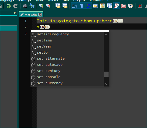

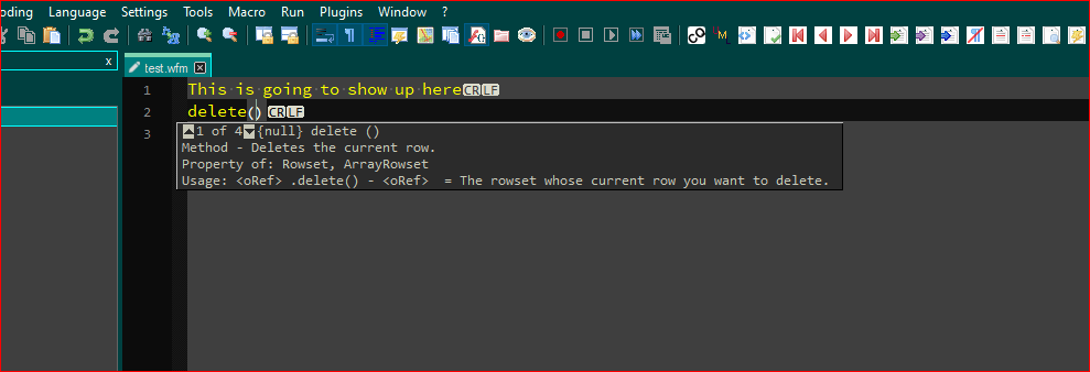

            Here’s a screenshot of that part of “Set” keywords in the autoCompletion dropdown list so it shows and inserts what you see, without any additional cleanup code:
            It took a lot of work with @PeterJones, @guy038 , @Alan-Kilborn , @Ekopalypse and others to learn all the nuances at the time that had to be overcome to make the language work with many of the features available in NPP for a UDL, short of building a lexer for it, like you’re doing now. :)

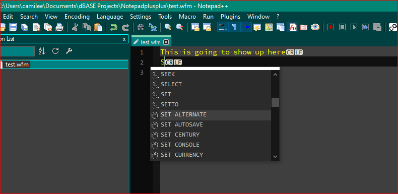

              Here’s an additional screenshot, showing it using the lower case display:
              Notice that the list isn’t the same, because some functions and methods used in the OOP version, don’t have capital counterparts, because when they’re used, they usually get inserted after a ., which doesn’t happen with strict procedural parts of the langauge, so if someone typed, for instance the SET command, and then a period, it wouldn’t show in the dropdown box, because there is no existent equivalent in the language. However if someone created one, then it would show in the dropdown list as previous words in the document, and allow them to reselect it. It took a while to figure out how to make NPP capabilities and dBASE’s OOP language extensions work together without forcing strict adherence to typographical conventions. :)

                      Notice the keyword only gets that one line entry, but functions /methods get the multiple line entry, and if any of the commands have multiple application you can add multiple Overload sections to expand it so that each will show up in the drop box when you type the first parenthesis that triggers the description/tips for the chosen word when it is meant to be used as a function/method rather than a command word. Note that it says 1 of 4 because there are 4 uses/variations of the command to choose from if you use the tip call to follow the hints of parameters to enter as shown in the below screenshot.
                      Note also, the previous code clip where the word is DELETE in caps, and there is no multiple Overload sections…that’s because when it’s used as anything other than a command, it won’t be in capitals, so it may have a lower case equivalent, but the lower case function/method use won’t have an uppercase equivalent.

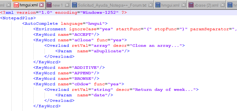

                        Anyway, I’m still learning details from your observations, and I’d like to know what programming environment you make your languagx.xml file for.
                        Regarding the documentation to copy and paste, I’ll give you the link so you can browse it (if you’re curious).
                        https://www.hmgforum.com/hmgdoc/data/index.htm
                        In one day with the help of Npp’s RegEx I loaded aprox. 780 descriptions of commands and functions.

                        From your previous comment I was able to assimilate an example of how to arrange the parameters, for which I only used one line. Thanks again! and hopefully my heart doesn’t fail me :¬) .

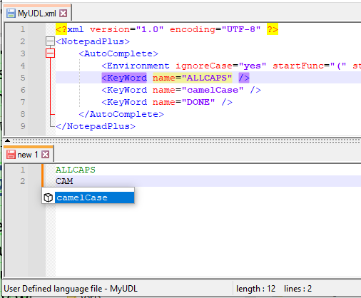

                            Hi,
                            Your example doesn’t work for me. I write “cam” and nothing happens, no suggestions. It is rather not correct. “all” and “don” work fine.

                              @Grzegorz-Śliwka said in autoCompletion Issue:
                              Whereas it did work for me. Without giving us more to go on, I cannot even begin to guess what you’ve actually done, and whether you’ve really set things up right according the instructions above. Sorry.
