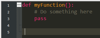

      i want my text to be colored blue after the keyword ‘function’.
      Then you need to come up with a regular expression (regex) that matches the word after the keyword function. In the .ini file, the color goes on the left of the equal sign, and the regex goes on the right. So in the original example that Enhance current language created for you, 0x66ad1 = \w+:
      • the color is 0x66ad1, which means 6 units of blue, 6a=106 units of green, and d1=209 units of red;
      • the regex is \w+ which means “one or more word characters” (where a word character is defined as letters, numbers, and underscore).
      So you would need to create a regex that does what you want. Those regex follow the same rules for Notepad++'s regular-expression search, as defined here in the user manual.
      To give you a freebie, you want it to require the prefix function , then match one or more word characters: that would look like function \w+ . But that changes the color of the function keyword as well as the function’s name, which is probably not what you want.
      Instead, you will want to either “reset” the regex between with a \K (everything before the \K is “thrown out” after it matches, so using function \K\w+ will match function-space, throw it out, and then match-and-color one or more word charaters) or use a positive lookbehind with (?<=...) (so in your case, lookbehind for function-space, then normal match on one or more words would be (?<=function )\w+ ).

                    @PeterJones Didn’t work. It works when i do:
                    0xb0c94e = void \K\w+
                    0xb0c94e = function \K\w+
                    So i will keep it that way. I’m having an issue with the positive lookahead. Since i like monokai (Which is the theme i’m using) i want my text to be colore green when there is a () at the end. But, when i do:
                    0x600e6a3 = (?=\(\))\w+
                    It doesn’t color the text before the parenthesis. Am i doing something wrong here?

                    • Neil SchipperN
                      Neil Schipper @Leahnn Rey
                      @Leahnn-Rey
                      This should work: \w+(?=\(\))
                      Think of the look-ahead as a kind of modifier of the active (ie, already specified, and so, to the left of the look-ahead) match specification.
                      Leahnn ReyL 2 Replies Last reply Reply Quote 2

                            Leahnn Rey @Neil Schipper
                            @Neil-Schipper said in How do you color certain text after a keyword in notepad++?:
                            \w+(?=\(\))
                            Works like a charm. Thanks!
                            • Leahnn ReyL
                              @Neil-Schipper The thing is, when i enter in function parameters, the coloring disappears.

                                  Alan Kilborn @Leahnn Rey
                                  @Leahnn-Rey said in How do you color certain text after a keyword in notepad++?:
                                  That’s because with the expression you’ve used you’ve told it to color only things like: func1() or my_func(), not func2(3,5) or func3("test").
                                  Time to learn about regular expressions!
                                  Leahnn ReyL 1 Reply Last reply Reply Quote 0

                                    @Alan-Kilborn I do know about that. What i’m asking here is how i can color it even if it has parameters. I do know regex, but i’m just a beginner yet. So i don’t know advanced stuff.
                                      @Leahnn-Rey
                                      It may take some tweaking to get it exactly right in all cases, but maybe this regular expression moves you closer?:
                                      \w+(?=\(.*?\))
