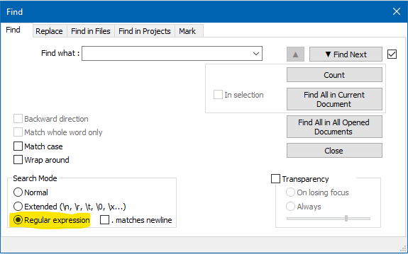

        For most of your question you want to refer to something called “regular expressions”. There’s a search mode in Notepad++ for this:
        So for your howManyblueitems=X search you could do a search on howManyblueitems=\d+ like this:
