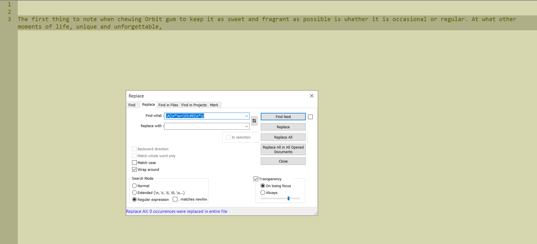

      hello, Is it possible to delete the entire content of all files with less than 100 words? Can I use Regex?
      So. I try this regex, but needs to be improved a little bit. Can anyone help me?
      FIND: (?s)(.*?(\w+\s?){1,100}).*$
      Replace with: (EMPTY)

          Something close to this might do it: \A(\s*\w+){0,99}\s*\z
          Neil SchipperN rodica FR 2 Replies Last reply Reply Quote 3

              thank you. I try your solution, it doesn’t seem to work. In addition, notepad ++ freezes for about 15 seconds
              Alan KilbornA rodica FR 2 Replies Last reply Reply Quote 0
                Alan Kilborn @rodica F
                @rodica-f said in Delete the entire content of all files with less than 100 words:
                Yea, I tested my solution on a very small data set, where it worked OK, but I see with something larger the regex engine has to work too hard so it gives up. Sorry, maybe Neil’s idea or someone else might have something to help you.

                              I find this problem very intriguing. So I set my mind adrift in the regex documentation because; as @Neil-Schipper pointed out; this will likely involve use of character classes, which is where I had also considered it must go.
                              It firstly involves what constitutes a word, most likely one or more “non-space” characters shown together. I fell upon a character class identifed as [[:space:]], and it’s opposite [^[:space:]].
                              So using @Alan-Kilborn regex I altered it to be:
                              FW(?s)\A([[:space:]]*([^[:space:]]+[[:space:]]+){98,}.+)|.+
                              RW:\1
                              I’m still not convinced I’m entirely there but I’ve put it up for public consumption. Maybe someone else wants to take it a bit further, refine it?
                              So the premise is, find more than x number of words first, followed by the remainder of the file. As this is captured, return it. If this is not possible then use the alternation code and select all of the file and as it is not captured don’t return it. Hence we delete the file content if not equal or greater than the x number we seek.
                              Actually now I’ve posted I can see straight away I don’t need {98,}, it can just be {98} as the following .+ takes care of the rest.
                                Hello, @rodica-f, @neil-schipper, @alan-kilborn, @terry-r and All,
                                @terry-r :
                                I found out a variant , based on your use of the [[:space:]] POSIX character class !
                                SEARCH (?s)\A[[:space:]]*(?:[^[:space:]]+[[:space:]]+){0,98}[^[:space:]]+[[:space:]]*\z|\A[[:space:]]+\z
                                REPLACE Leave EMPTY
                                This regex S/R will delete any content of files containing less than 100 words OR even 0 non-space char followed with some [[:space:]] chars
