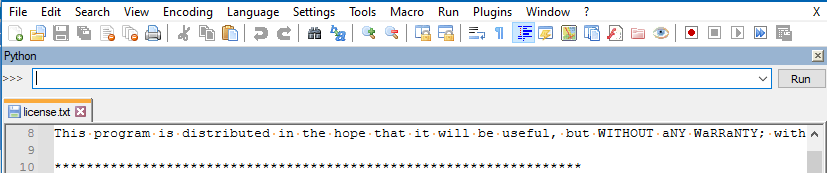

                        I experimented a bit with Visual Studio’s (Find/)Replace box, as an example of one that is smaller than N++'s:
                        I notice that it does the incremental-search behavior when typing “find” text, with the difference to N++ in that I can find my original start point easily if I want to.
                        Some of the dropdown content:
                        The functionality all seems to be here in this compact UI, with the exception of a “replace all in direction” capability found in N++.
                        It gets even smaller if you just want to find, not replace:
                        I think N++ could benefit from something like this, being “compact”.
                        BTW, the icons on the bottom row from L to R are:
                        • match case
                        • whole word only
                        • normal/regular expression mode
                        The icons to the right of the Replace box are “replace next” and “replace all”.
                          Forgot to mention: While it appears that with the correct settings you can do a find-in-files or a replace-in-files with that compact UI, Visual Studio also has a larger UI for those things, offering tighter control over options (e.g. file types, equivalent to N++'s Filters)
                            I could see a compact Find/Replace/Mark UI across the top of my N++ window, like this where I show the Python console window in this location:
