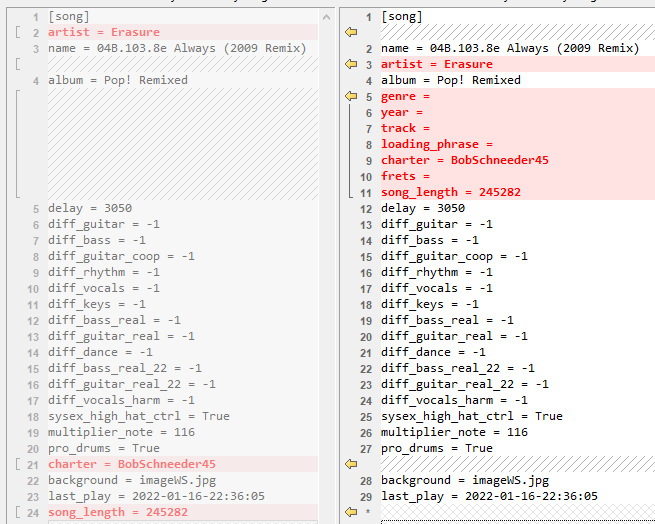

                            Mathias Lujan
                            Otherwise, I’m extremely grateful to @mpheath who gave me the solution “clé en main” (ready to use). I have understood it thanks to his explanations. I have implemented both Notepad++ Python Script and Standalone recursive Python Script : both work perfectly.
                            I might even consider changing more elements very easily (thanks to list ‘presets’), and, amazing, modify the 5000 files without open them in Notepad++ (a lot of time saving). That’s a lot more than I expected.
                            BIG THANKS to @mpheath and other for contributions.
                            I share with you the two scripts in final version.

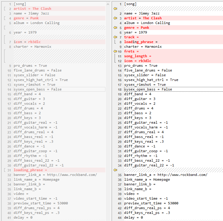

                              See how long a discussion thread can go on when the problem statement is imprecise? I don’t know that it really is precise yet. Here’s how I see the problem:
                              If lines starting with these items are present, move them to the top, and put them in this exact order:
                              name =
                              artist =
                              album =
                              genre =
                              year =
                              track =
                              loading_phrase =
                              charter =
                              frets =
                              song_length =
                              icon =
                              If they are not present, make them present but be empty, e.g. frets = and then nothing following.
                              For any other lines, leave them as they are after the icon = line in the output.
                              Mathias LujanM 1 Reply Last reply Reply Quote 1
                              • Mathias LujanM
                                Mathias Lujan @Alan Kilborn
                                @alan-kilborn I’m sorry again. I try to do my best…
                                Your formulation is perfect.
                                Just a detail, ‘icon =’ is not important for me. So :
                                For any other lines, leave them as they are after the ‘song_length =’ line in the output.
