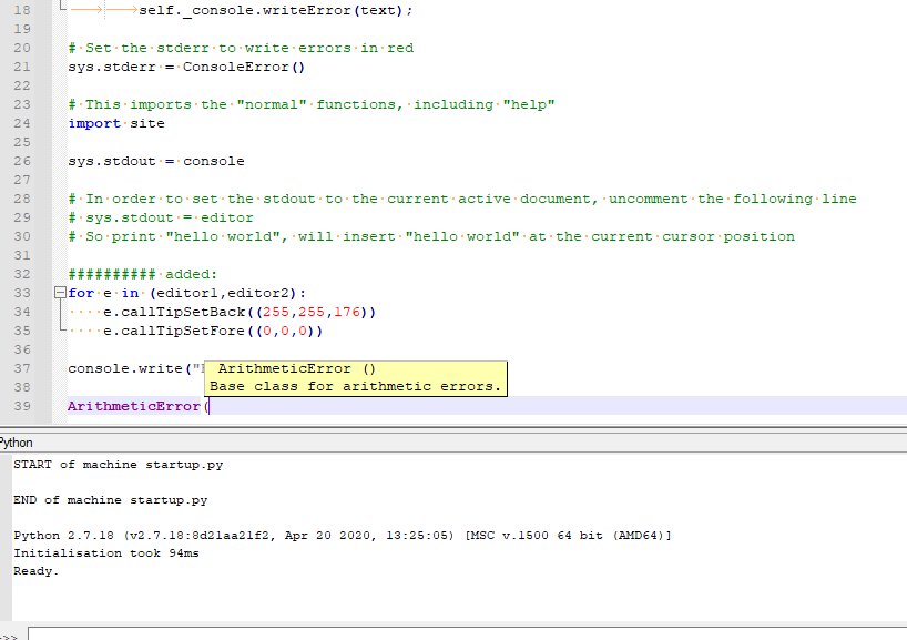

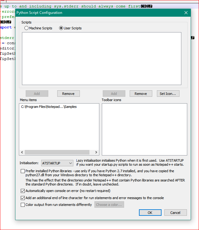

      Ok. Here’s a screenshot of my config Machine view:
      I can do what ever you suggest, if I am setup right. That is the question we’re looking at. :-)
      Lee

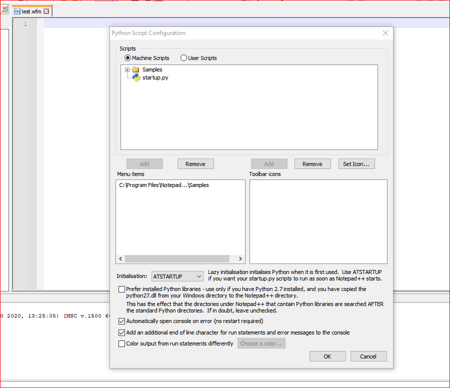

        Ekopalypse @Lycan Thrope
        @lycan-thrope
        and in User Scripts there is nothing?
        My fresh setup test

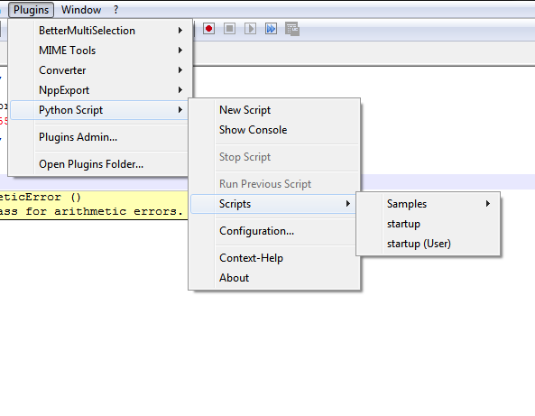

          Also, you should really look at your Plugins > Python Script > Configuration like Eko showed:
          If you have User Scripts selected and don’t see startup.py in the Scripts box (like Eko’s is empty), then you do not have any user scripts… which means, if you think you are editing the user startup.py like Eko suggested earlier, you are not. edit: if you’re intentionally just using system startup.py, that is of course your perogative.
          At this point, showing us the screenshots of User Scripts and Machine Scripts, with startup.py visible in both (if they exist) would be great – oh, you’ve posted machine-scripts while I was writing this paragraph; along with the copy/paste of your current Debug Info , along with the exact location of the startup.py that you are editing.

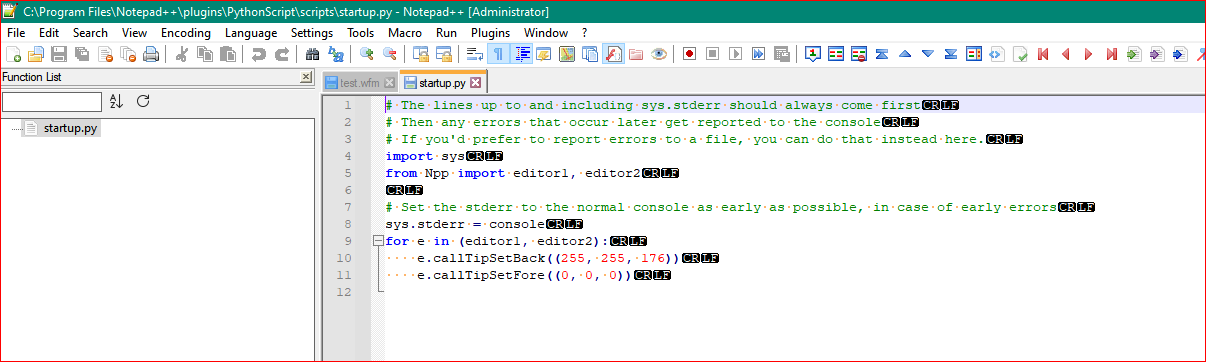

            • Lycan ThropeL
              Lycan Thrope @PeterJones
              @peterjones ,
              I “Run as Admin”, right click on starting NPP. I am in Admin mode, as far as I know, but still seem to have to open certain things “Run as Admin” when I want to save to admin only areas with applications. I could be wrong, however and it would be the first time. :-)

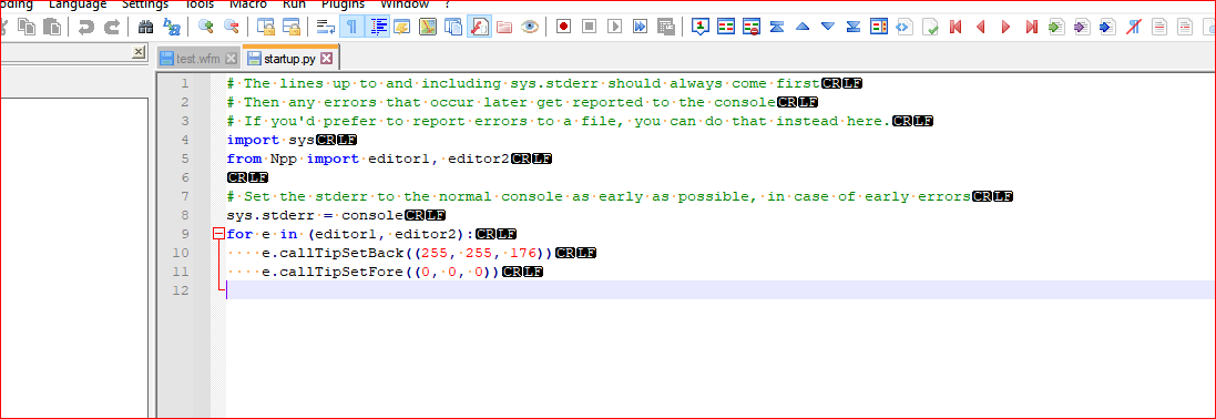

              This is the Config User Script section:
              And this is the file location on the Header bar showing the path to the current file:
              Lee

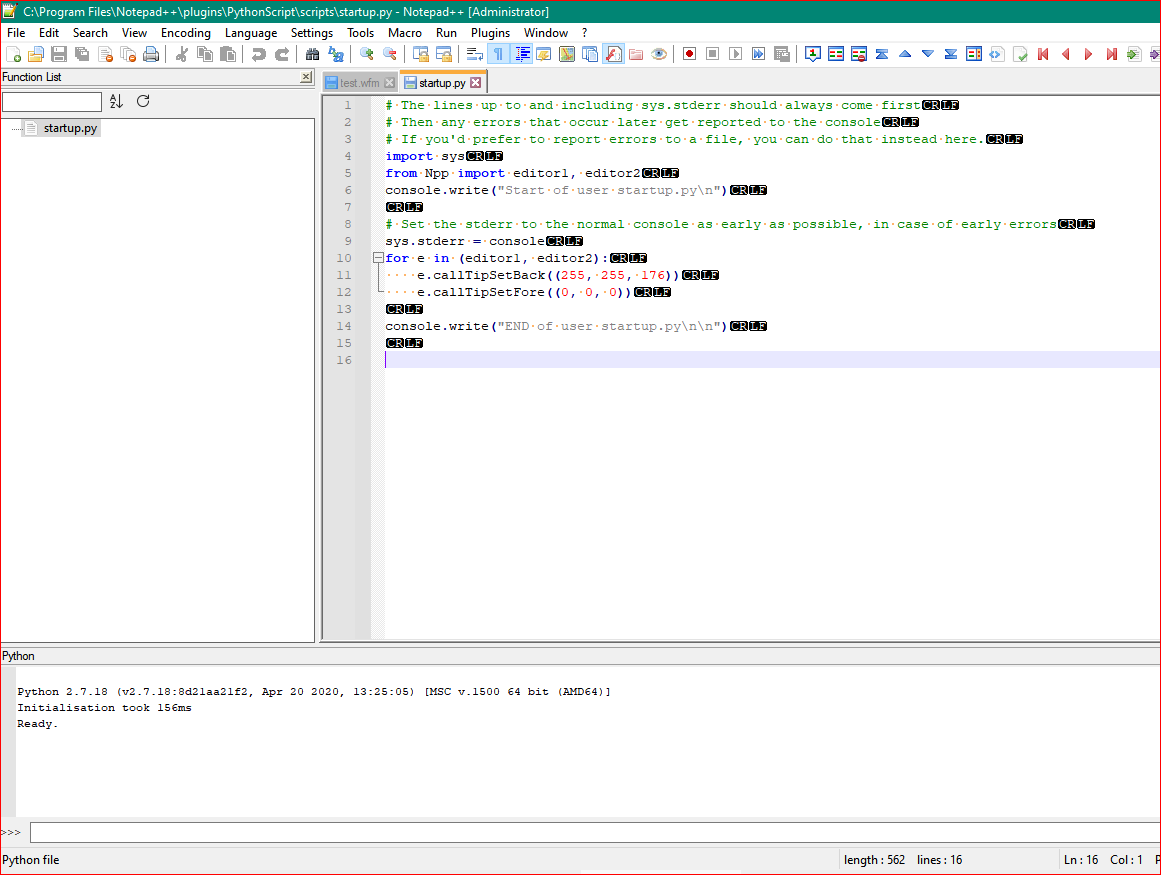

              • Lycan ThropeL
                @peterjones ,

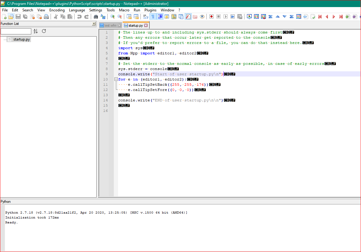

                Took your hint, Peter, added the two lines you suggested, in the “supposed” auto startup, and it’s not running as far as I can tell. Here’s the screenshot after changing and adding those lines to what I presume is the actual startup file, rebooted NPP, restarted “Run as administrator”, and this is the result:
                As you can see, no lines in the console.
                And the prior statement, though tongue in cheek, was a typo also, meaning, it’s not like I haven’t been wrong before so I may well be wrong this time, about being in the Admin mode running my system.
                Lee

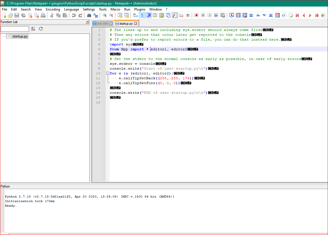

                  On the off chance I had the first line in the wrong place, I put it below the console redirection, saved, rebooted, restarted as admin and took this shot, still no response:
                  • Lycan ThropeL
                    Lycan Thrope @Lycan Thrope
                    @lycan-thrope
                    And just in case that asterisk was supposed to be put at the front of the import, I included that again and rebooted and ran, with the same result:
                      Michael Vincent @Lycan Thrope
                      @lycan-thrope said in Call Tip Color change:
                      Not a Python expert, but surprised you’re not getting an error. You only import editor1 and editor2 from Npp, not console, but you proceed to call console. I checked, there doesn’t seem to be a console method in sys so not sure why you’re not seeing an error.
                      Maybe your Npp import line should be :
                      from Npp import console, editor1, editor2
                      or better yet, since it’d be beneficial to import all Npp into your PythonScript console:
                      from Npp import *
                      • Did you try not running in Admin mode?
                      • Did you try to use the user startup.py located in (assuming from your image):
                        C:\Program Files\Notepad++\plugins\Config\PythonScript\scripts\startup.py

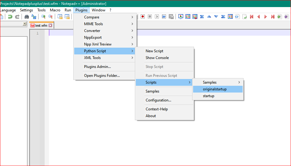

                        PeterJones @Lycan Thrope
                        @lycan-thrope
                        So it’s obviously not running the startup.py that you are editing.
                        When i run, I will see:
                        or
                        (so when I change the color and restart notepad++, it changes the color)
                        Running in Admin mode is just asking for trouble. But I tried with my portable setup (the one I am showing), and it still ran my startup script
                        I don’t know what you’ve corrupted, but you’ve done something tp mess it up so it’s not trying to run the startup.py … Please reset to the file below

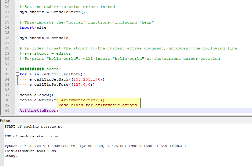

                              Well, it appears the mucking about may have been the problem, but I came here right after it didn’t run, as is. Thank you, and now I have to figure out why it didn’t work as is, but at least I have a working example to learn from. I’m sorry if this is frustrating to you. It is to me, too. I try to follow exact directions when I do this stuff and for some reason, it sometimes doesn’t work as is. Mind you, after you help me get it going, when I pass it on to the community, I have to be able to answer as well, why something isn’t working when just following the standard install and running of the plugin.
                              Here’s your script pasted in, restarted, and the results:
