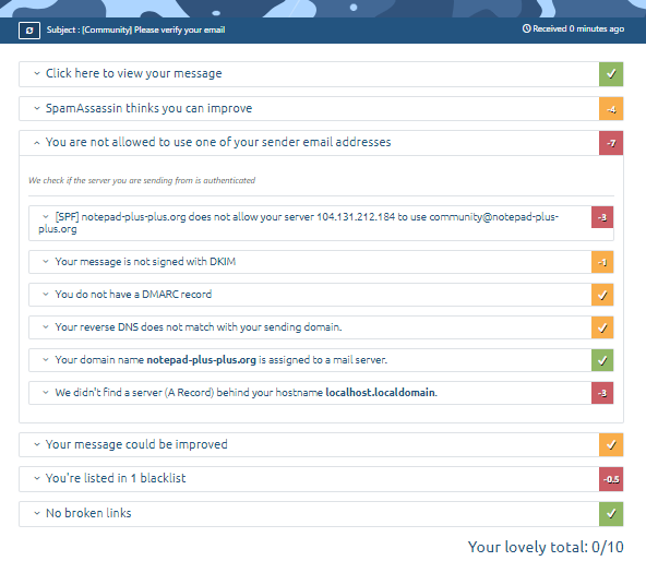

      I just created don.ho@notepad-plus-plus.org (and it’s the only one account on notepad-plus-plus.org so far.
      And here is the log of email:
      I’m wondering if I should create the account like admin and news-noreply ?

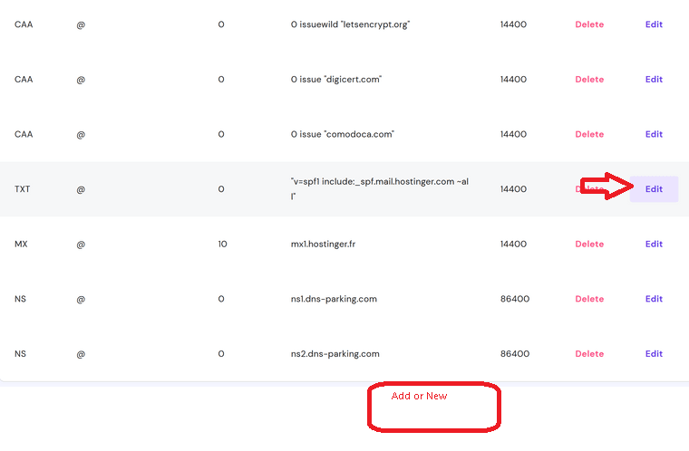

        and if you want the forum emails to properly have the SPF, it will have to be more like what I showed in January (edited for the new hostinger-default text): v=spf1 include:_spf.mail.hostinger.com include:relay.mailchannels.net include:digitalocean.com ip4:104.131.212.184 ~all – the extra includes, and the ip4, will allow addresses associated with the emails from the Community Forum to also be allowed.
        So should I edit it to the value you suggested?
        donhoD PeterJonesP 2 Replies Last reply Reply Quote 0

          I’ve just edited the entry I showed you on the screenshot above to the value you suggested, and back to the email section:
            PeterJones @donho
            @donho ,
            Yes, I would say to Edit the one you have highlighted to the value I supplied.
            And if there’s an Add or New button not shown, I would use that to create a new TXT record with the name _dmarc and the value v=DMARC1; p=none; rua=mailto:don.ho@notepad-plus-plus.org
            Also, if you could send me an email (I believe you can look at my profile and see my configured email) from the don.ho@notepad-plus-plus.org address, it should put useful information in the headers, which I can use to help you confirm whether that’s gotten set up right or not.

                There’s control for adding entry:
                But what kind of info should I provide to the 3 first case?
                  PeterJones @donho
                  @donho ,
                  TYPE should be TXT
                  NAME should be _dmarc or _dmarc. (different interfaces differ on whether or not they want the . after the name)
                  POINTS TO should be the value v=DMARC1; p=none; rua=mailto:don.ho@notepad-plus-plus.org

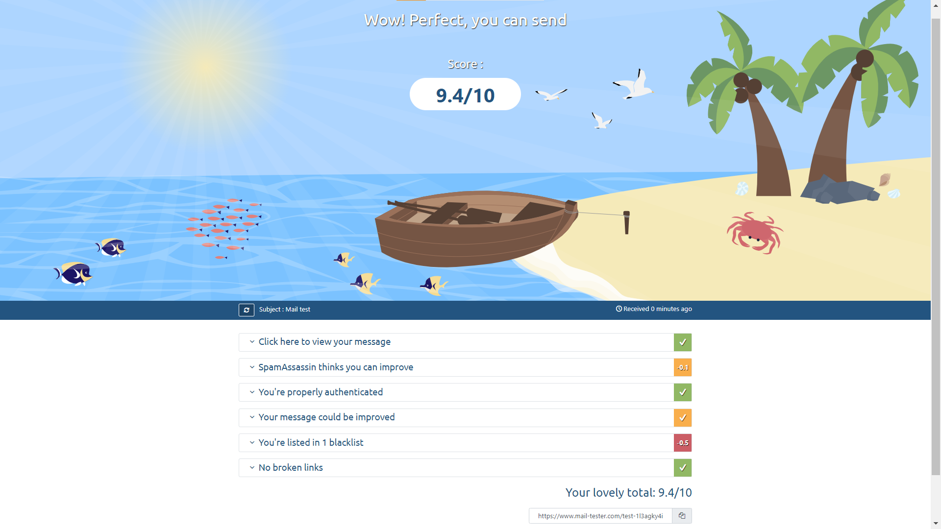

                            @timint01 and All,
                            Don and I have been working back and forth. I think we’ve finally got it set up right, so that the DKIM and DMARC will be set correctly – at least, it has in the test emails I’ve sent.
                            I was able to send a test message to an alternate gmail account, and that accound received the email (which it never did before).
                            Please let us know if it’s still showing up as spam. And thanks to @donho for his patience while I kept dreaming up new experiments for him to try.
