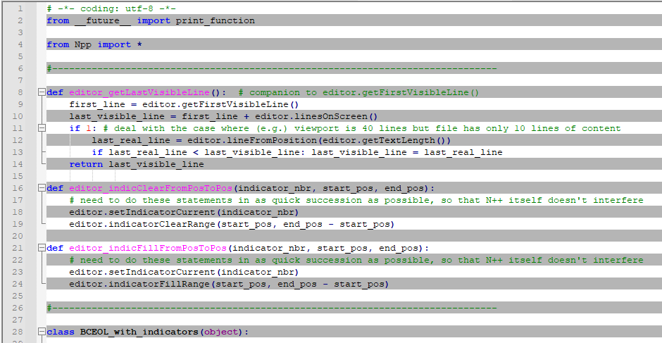

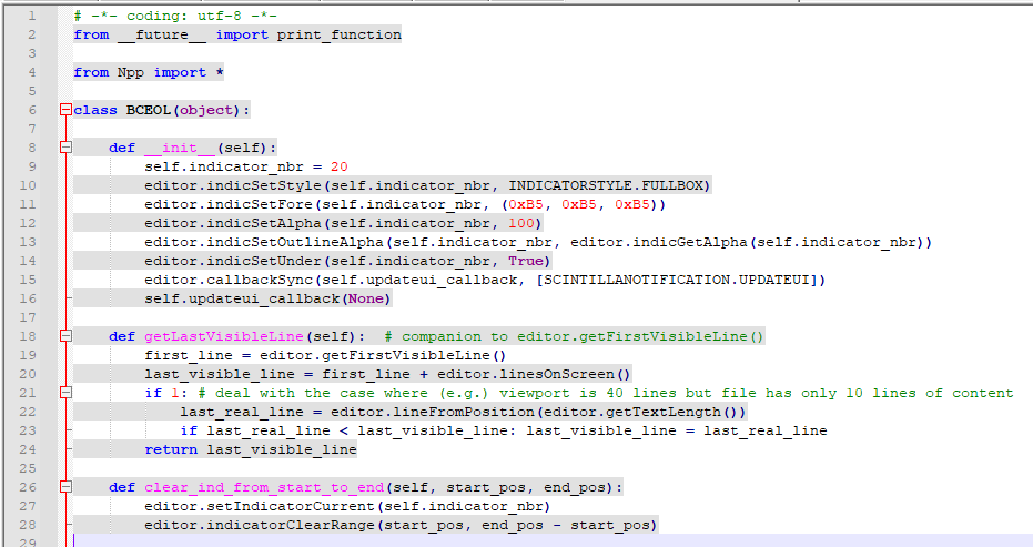

      So the above is really just a “demo”, but, as sometimes happens here, after writing a demo, I find a real use for it.
      When that happened this time, I noticed that if the script is run while a “view 0” tab is active, it won’t cause the every-other-line shading to happen for a tab in “view 1”.
      This can be avoided by changing the script code to influence both editor1 and editor2.
      For the marker-based coloring, the marker init code could be changed to:
      for e in (editor1, editor2):
          e.markerDefine(self.marker_id, marker_symbol)
          e.markerSetBack(self.marker_id, (0xB5, 0xB5, 0xB5))
      For the indicator-based coloring, the indicator init code could be changed to:
          e.indicSetStyle(self.indicator_nbr, INDICATORSTYLE.FULLBOX)
          e.indicSetFore(self.indicator_nbr, (0xB5, 0xB5, 0xB5))
          e.indicSetAlpha(self.indicator_nbr, 100)
          e.indicSetOutlineAlpha(self.indicator_nbr, e.indicGetAlpha(self.indicator_nbr))
          e.indicSetUnder(self.indicator_nbr, True)
      edit: fixed indicator vs marker to make descriptions match code snippets

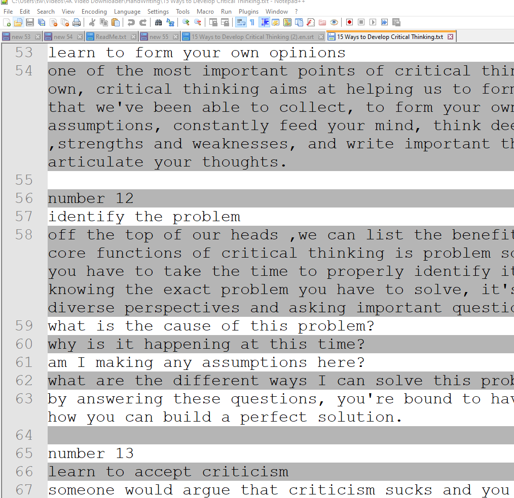

                    If selected Word Wrap, the display as below,if possible,please modify the code to highlight lines with color one by one.
                    Best Regards
                      Alan Kilborn @T W
                      I don’t think what you’re asking for is possible.
                      But…when you really sit back and consider it, isn’t it better the way your example shows it anyway?
                      A line that is visually wrapped so it appears on 2+ lines is still only one line…

                        T W @Alan Kilborn
                        @Alan-Kilborn said in How to highlight lines with color one by one?:
                        The interlaced brightening function increases the Angle of view of the eye by 3 times, reducing the load of the eye and improving the reading speed. I think it’s still necessary to focus on the visual line rather than the document line. I would like to try to change it based on yours. Can you give me some clues, such as the keywords you use, grammar and other background knowledge?

                          I took a closer look at the script, and I think I’ve changed my mind about it not being possible. Let me see if I can put together a changed script that will do as you want…

                              @T-W
                              I’m going to waffle back to my original comment in that the new desire isn’t reasonably possible. In the original script, position is used heavily to decide where to put the “coloring”. While line information (both document and display) is easy to obtain, position data for wrapped lines (e.g. position of where each wrapping occurs) doesn’t seem to be available.
                              Now I’m not going to say it is impossible, because software is amazing and can do extraordinary things, but I think it would be a bigger effort than I consider worth it to put in. Unless…someone sees it differently and there is a straightforward way to do it.
