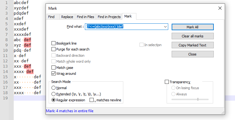

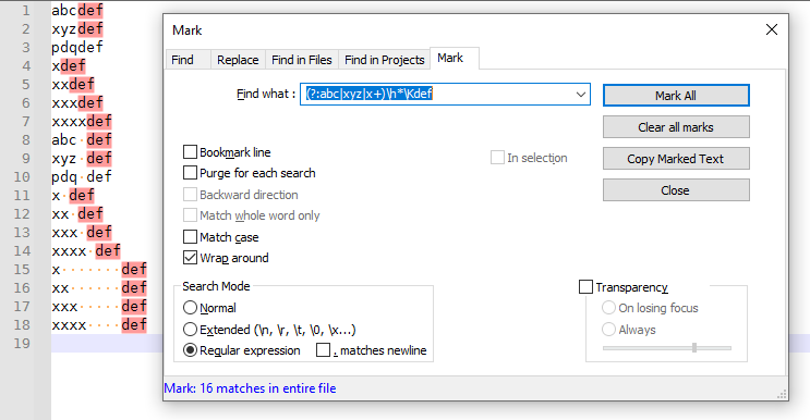

                                PeterJones @Scott Nielson
                                @Scott-Nielson ,
                                Anything you put before the \K will be effectively “lookbehind”. Before that \K, you can use any valid regex syntax, which will carry the same meaning. So if you want to match the def, but only if it’s prefaced by abc or xyz, or one-or-more-xes, and with zero or more spaces between it and the def you could look for (?:abc|xyz|x+)\h*\Kdef – this will match the def in abcdef or abc def or abc def (with lots of spaces between, which the forum won’t let me show) or xyz def or xxxxxxx def or xdef or many others.
                                (In your actual example of xxx, and without the variable number of spaces, there would have been no reason for the \K, and you could have used a normal lookbehind, because the number of characters could be exactly known by the regex engine: (?<=(abc|xyz|xxx) )def . Thus, I changed the example to something that could match any number of characters, and thus wouldn’t work in a normal lookbehind situation.)
                                (I added spaces while writing this up, because your multiple posts and edits were moving in that direction)
                                  Examples:
                                  abcdef
                                  xyzdef
                                  pdqdef
                                  xdef
                                  xxdef
                                  xxxdef
                                  xxxxdef
                                  abc def
                                  xyz def
                                  pdq def
                                  x def
                                  xx def
                                  xxx def
                                  xxxx def
                                  x       def
                                  xx      def
                                  xxx     def
                                  xxxx    def
                                  Scott NielsonS 3 Replies Last reply Reply Quote 1
                                          @Scott-Nielson ,
                                          I am not here to be your personal regex writer and regex debugger, sorry. I gave you general principals. I gave you specific examples. We have linked you to regex documentation. I’m not sure what else you can reasonably expect from us.
                                          As we said, if the length varies, \K is equivalent to lookbehind. You need to use whatever syntax works for your particular situation. Your brief examples aren’t enough for us to know if they’ll work for your actual needs.
                                          As a parting help,
                                          1. I have no idea why you suddenly switched to negative lookbehind. All your descriptions have said “I want to match the def assuming that abc or xyz or xxx come before it”. But the regeex you just proposed says “match def as long as none of abc or xyz or xxx come before it” which is literally the opposite of what you’ve previously asked for.
                                          2. Why did you put def in a lookbehind when you wanted it to be part of the match itself. From that, you would just want (?<!abc)(?<!xyz)(?<!xxx)def – with the def not in a lookbehind.
                                          But, to use an analogy: it’s time for you to take off the training wheels and try to learn how to balance and bicycle on your own. You need to learn regular expressions enough that you can do it without constantly relying on us to guess whether or not a regular expression will work for the data that we cannot see that you don’t accurately describe to us.
                                          Please note: This Community Forum is not a data transformation service; you should not expect to be able to always say “I have data like X and want it to look like Y” and have us do all the work for you. If you are new to the Forum, and new to regular expressions, we will often give help on the first one or two data-transformation questions, especially if they are well-asked and you show a willingness to learn; and we will point you to the documentation where you can learn how to do the data transformations for yourself in the future. But if you repeatedly ask us to do your work for you, you will find that the patience of usually-helpful Community members wears thin. The best way to learn regular expressions is by experimenting with them yourself, and getting a feel for how they work; having us spoon-feed you the answers without you putting in the effort doesn’t help you in the long term and is uninteresting and annoying for us.
                                          Scott NielsonS 2 Replies Last reply Reply Quote 1
