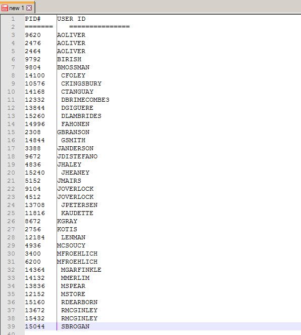

      Hi, all! Please take a look at this example.
      So, I’m using (SHIFT-CTRL-ALT + Left Click) to set this inside column (temporary column blinking cursor from top to bottom).
      How can I indent (aka backspace) all the text on each row, to the right of the blinking column, so it left aligns to this inside column I’ve selected. Is there a way to do this within NP++ itself, or do I need a plugin? I’ve been fiddling with Column Tools plugin, but no luck so far.
      I have a feeling I’m missing something obvious.
      Thanks in advance!
      • artie-finkelsteinA
        artie-finkelstein
        I’d probably:
        • use \Edit\Column Editor… to insert row numbers into the document at the left most edge
        • use the NppColumnSort plugin to sort on the USER ID column
        • use regular column mode editing to remove the leading space(s) from the IDs
        • resort the file based on the index numbers added to the left most edge
        • use regular column mode editing to remove the leading index numbers
        • yell at the original programmer for not sanitizing the data before storing it <grin>
        NppColumnSort is not in the Plugin Manager and is available as separate 32 bit or 64 bit releases. The plugin uses an intermediate ‘template’ to select the sorting column(s); this allows for multiple levels of sorting, but an entry must be made into the template area, even for a single level of sorting.
        • astrosofistaA
          astrosofista @Chris Tanguay 0
          @Chris-Tanguay-0, @artie-finkelstein,
          I would do it as follows:
          Giphy
          How it works? First off, open Preferences -> Editing, and enable the Multi-Editing Settings. It also requires the BetterMultiSelection plugin activated, which you can download and install via Plugins Admin.
          Then, do as the movie shows:
          1. In the second line, place the caret at the left of the USER ID column.
          2. Press Shift + Alt and move the caret from the top line until the bottom of the list with the arrow down — you will get a giant caret blinking along 14 lines with no characters selected.
          3. Press Shift + End to select till the end of each line.
          4. Then press Shift + Control + Arrow Left to just select the spaces you want to delete.
          5. Lastly, press delete.
          You’re done. Hope you like it.
          artie-finkelsteinA Maria BenichM 2 Replies Last reply Reply Quote 4

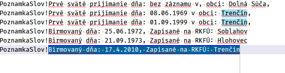

                                            Let’s see an example to illustrate these ideas, copied from this post:
                                            PoznamkaSlov!Prvé sväté prijímanie dňa: bez záznamu v, obci: Dolná Súča,
                                            PoznamkaSlov!Prvé sväté prijímanie dňa: 08.06.1969 v obci: Trenčín,
                                            PoznamkaSlov!Prvé sväté prijímanie dňa: 01.09.1999 v obci: Trenčín,
                                            PoznamkaSlov!Birmovaný dňa: 25.06.1972, Zapísané na RKFÚ: Soblahov
                                            PoznamkaSlov!Birmovaný dňa: 21.09.1973, Zapísané na RKFÚ: Hlohovec
                                            PoznamkaSlov!Birmovaný dňa: 17.4.2010, Zapísané na RKFÚ: Trenčín
                                            OP wanted to remove the text between the exclamation point in column 13 and the last colon, whose position varies in almost every line. There is no regular pattern of spaces, since the lines have between 5 and 7 spaces, nor is the distribution of delimiters after the colon regular. Thus, it is not possible to advance from column 13 or from the end of the line. The only interesting regularity is the exclamation point column.
                                            Another approach is needed. My first idea was to take into account a resource I mentioned in a previous message and that is to modify the word delimiter, in the preferences. If you add " ," in the corresponding field, it becomes possible to easily select the text to delete.

                                            1. Insert a multi-selection after the exclamation point column.
                                            2. Ctrl + Shift + End to select to the end of each line.
                                            3. Then Ctrl + Shift + Arrow Left to deselect up to the colon.
                                            4. Finally, delete the selected and unwanted text, pressing Back-Space.
                                            BTW, don’t forget to reset the word delimiter, or unexpected things may happen.
                                            The second idea, which came to me afterwards, turned out to be simpler - it does not require changing preferences - and is therefore better. While you can begin from the exclamation point column, for the sake of variation I’m going to start at the other end. I’m going to select column 55, that is, two characters before the colon in the last column. The idea is to remove all the unwanted characters to the right of column 55, because this creates the conditions to make a rectangular selection and easily delete the remaining text:
                                            Giphy
                                            1. Insert a multi-selection at column 55.
                                            2. Ctrl + Shift + Arrow Right to select the characters up to the colon. Repeat the action to add the colon to the selection.
                                            3. Press Back-Space to delete the selected text. We are left with a straight right margin and since the left margin is also straight, we are able to make a rectangular selection.
                                            4. Press Shift + Alt + Click after the exclamation point on the first line.
                                            5. Press Back-Space to delete the selected and unwanted text.
                                            That’s all. Hope you find this post useful.
