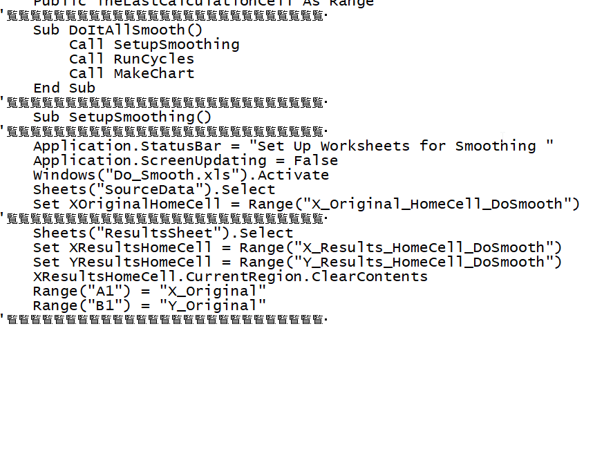

      Alfred Vachris
      This does not happen with notepad?
      Can you tell me how to avoid this problem?
      Regards
      Alfred (Excel1Star)

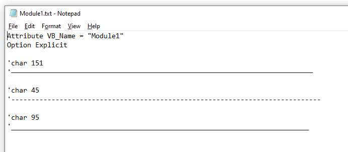

                  I am using VBA to extract source code for Excel projects.
                  My style for VBA coding is to use a line of '——————— to block off “paragraphs” of code.
                  I like to use char(151) because it divides the line in the middle.
                  When I open the extracted source code in NotePad++ I see the weird Unicode.
                  If I open the same source in notepad - no Unicode is displayed?
                  How can I send you a sample source code file?

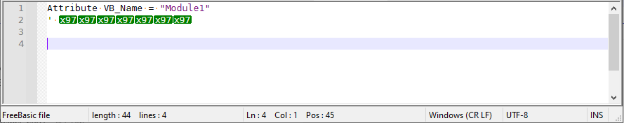

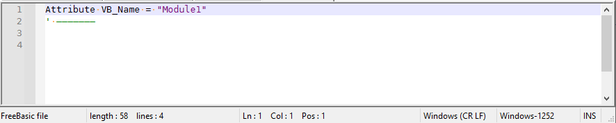

                      I exported a VBA module that was just

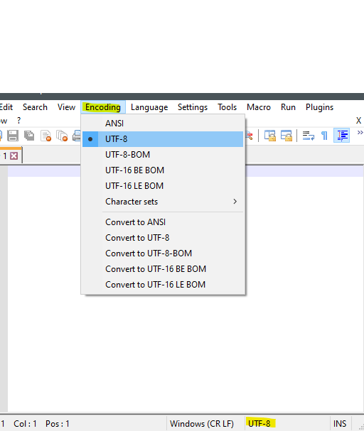

                      … when I opened in Notepad++, Notepad++ decided it was ANSI, as it shows in the next-to-last section of the status bar:
                      On my machine, the default ANSI codepage is 1252 (so standard western charset)
                      If Notepad++ had mis-interpreted it as UTF-8, it would show a bunch of x97 in dark boxes, because the char(151) is 0x97, and is not a valid byte on its own in UTF-8.
                      If that were the case, you could use Encoding > ANSI (note: not Encoding > Convert to ANSI) to get Notepad++ to re-interpret as ANSI (and for me, 1252).
                      But your original screenshot showed something that looks like a non-Western character… so it doesn’t seem to be interpreting it as UTF-8. My guess is that you have a different default character set. If your status bar says ANSI (or a different character set than Windows 1252) when it’s showing those non-Western character, you might try Encoding > Character sets > Western European > Windows 1252, which would cause Notepad++ to re-interpret your file as Win-1252, which I think is what Excel uses during export (at least, it did for me… but again, my PC’s default character set is 1252, so…)
                      Alfred VachrisA 2 Replies Last reply Reply Quote 3

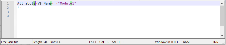

                          @alfred-vachris ![alt text](underscores extracted opened in notepad pp.png image url)Under Scores extracted an opened in notepad.png
                          Lycan ThropeL PeterJonesP 2 Replies Last reply Reply Quote 0

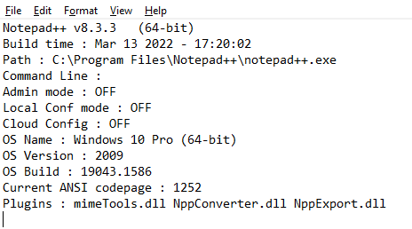

                            You have yet to post your debug information by copying the information from the ? in Notepad++, so the folks here can actually see what your NPP version is showing it’s using. Although anytime I see a Kanji type character my first thought is that you have a codepage set that doesn’t match one or the other applications setting that you are copying from, and pasting to. Please provide this information so they can better get a sense of what they’re working with.

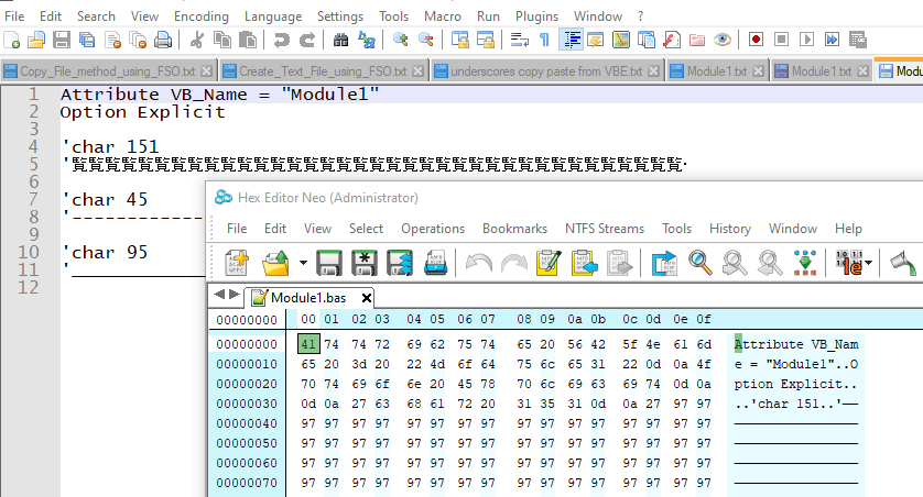

                              Alfred Vachris @PeterJones

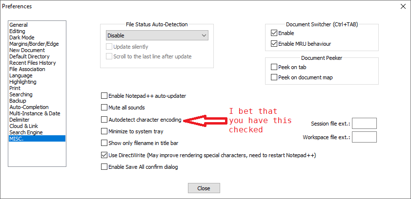

                                Remember when I mentioned the status bar? Did you notice what you left out of every single one of your Notepad++ screenshots: the status bar. It has the encoding/charset information that was required for us to give you any more information.
                                Your problem is that the encoding isn’t right for the file you are trying to read. But you are not telling us anything about what encoding Notepad++ thinks it is. Even if you refuse to do that, you could have tried my experiment of changing the charset
                                Remember when I said “I assume the latter”: I was expecting you to either confirm that assumption, or contradict it. Your silence on that matter gave no new information.
                                If you want us to help you, you have to answer questions we ask, and try experiments we suggest. If you refuse, you will not get your problem solved, because we are not mind readers.

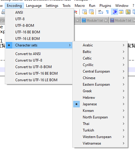

                                    Ok, the encoding has somehow switched to Japanese?
                                    How would this happen?

                                        @alfred-vachris ,
                                        Even though you still didn’t show me the status bar – it’s the little information row at the bottom of Notepad++ – I will give you one more gift. I am doing this because the alternate information was sufficient. I can now replicate what you see easily:
                                        And the fix shown is something I said to try two hours ago.
                                        But since you decided against trying what I suggested, then you didn’t get your solution then.
                                        There must be some sequence of characters in the extracted VBA code that is triggering the switch to Japanese?
                                        This happens because you’ve told Notepad++ to try to guess the encoding in the Notepad++ options
                                        Notepad++ does its best. But some sequences of characters confuse it. As you can see, I turn that off.
                                        If you ever leave it on, if the characters show up and they don’t look like what you expect, always check the encoding (on the Status Bar, also shown in the Encoding menu, and change the encoding to match the encoding of the source file)
                                        Alfred VachrisA Lycan ThropeL 2 Replies Last reply Reply Quote 3

                                          You were spot on about the autodetect character encoding.
                                          That has cleared up my problem.
                                          Now my extracts are a thing of beauty!

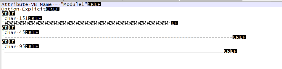

                                            Hello @alfred-vachris, @mere-human, @peterjones, @alan-kilborn, @lycan-thrope and All,
                                            I’m a bit late and I should had suspected, like Peter, the Autodetect character encoding option !
                                            Now, of course, it easy to understand all the story…

                                            => This time, the line of the 41 EM dash chars is replaced with a line of 20 identical ideograms, followed by a kind of dot and the LF char
                                            => In the status bar, the encoding have been changed to Shift-JIS !
                                            How to explain this result ?
                                            Well, the Shift-JIS encoding is a Japanese double byte character set ( DBCS ). This name is a bit of a misnomer as it should be called a Multi-Byte character set ! Indeed, like Chinese and Korean encodings, this encoding maps some characters with 1 byte and some others with 2 bytes.

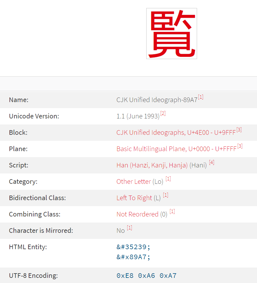

                                            Now, as the hex value of the 151 char is 0x97, this means that it is a lead byte for the Shift-JIS encoding
                                            And it happens that, in the part :
                                            0x9795	0x85CD	# <CJK>
                                            0x9796	0x862D	# <CJK>
                                            0x9797	0x89A7	# <CJK>
                                            0x9798	0x5229	# <CJK>
                                            0x9799	0x540F	# <CJK>
                                            0x979A	0x5C65	# <CJK>
                                            0x979B	0x674E	# <CJK>
                                            The 0x9797 values ( first and second byte ) corresponds to the Unicode char 0x89A7. This is, also, in line with the decimal value 35239, used by @alfred-vachris, in the ReplaceUnicode() function :
                                            Function ReplaceUniCode()
                                            Dim Instring As String
                                            Dim CodeNumber As Long
                                            Instring = Application.Caller.Offset(0, -2)
                                            ReplaceUniCode = Replace(Instring, WorksheetFunction.Unichar(35239), “-”)
                                            End Function
                                            So, the first 40 EM dash chars are changed into 20 characters 0x89A7 ! Then, the 41th char 0x97 is again a leading byte which is followed by the 0x0D char, as a second byte. However, the sequence 0x97 - 0x0D does not correspond to a valid char, as the correct two bytes range is from 0x97 - 0x40 to 0x97 - 0xFC. Thus, the Shift-JIS uses a replacement character.
                                            By successive tries, I found out that the final “dot” char is the \x{30FB} character ( KATAKANA MIDDLE DOT ). And, in the Unicode article :
                                            https://www.unicode.org/versions/Unicode14.0.0/ch18.pdf
                                            it is said, at bottom of page 755 :
                                            Punctuation-like Characters. U+30FB katakana middle dot is used to separate words when writing non-Japanese phrases.
                                            So I suppose that the \x{30FB} char is used as the replacement char of the last unknown sequence 0x97 - 0x0D, because the Shift-JIS encoding considers this sequence as possible non-Japanese text ?
                                            Of course, the structure of the line is preserved thanks to the EOL char \x0A !

                                            • Select the option Settings > Preferences... > MISC
                                            • Untick, if necessary, the Autodetect character encoding option
                                            • Close the Preferences dialog
                                            • Restore recent closed file ( Ctrl + Shift + T )
                                            => The line of EM dash \x{2014} is normally displayed
                                            => In the status bar, you see the mention ANSI
                                            • Choose the menu option Encoding > Character sets Japanese > Shift-JIS
                                            => Again, the ideograms are present with \x0A only as line-ending
                                            => In the status bar, you see that the expected encoding is Shift-JIS
