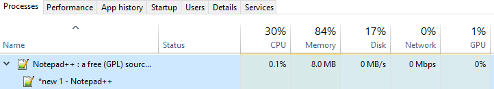

      Hi, I recently installed notepad++ version 8.1.1 and I am noticing that it is constantly using about 17% CPU
      I am running Windows 10 on my Surface Studio with an Intel i7 processor and 32gb of Ram.

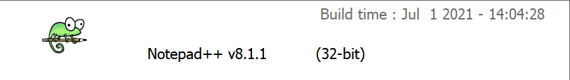

      This is my version of notepad++
      Please let me know if this is normal, and if not, what can I try to do about it.

          Here is my debug info:
          Notepad++ v8.1.1   (32-bit)
          Build time : Jul  1 2021 - 14:04:28
          Path : C:\Programs\Notepad++ - Copy\notepad++.exe
          Command Line :
          Local Conf mode : ON
          OS Version : 2009
          OS Build : 19042.1110
          Current ANSI codepage : 1255
          Plugins : BetterMultiSelection.dll ColorPicker.dll ComparePlugin.dll DSpellCheck.dll ElasticTabstops.dll Explorer.dll FileSwitcher.dll FingerText.dll LightExplorer.dll LocationNavigate.dll LuaScript.dll mimeTools.dll NavigateTo.dll NppConverter.dll NppExec.dll NppExport.dll NppFTP.dll NppTextFX.dll PythonScript.dll ScrollPastEOFUni.dll SurroundSelection.dll WindowManager.dll XBrackets.dll zoomdisabler.dll _CustomizeToolbar.dll
          If you think that I need to start testing without plugins, Let me know

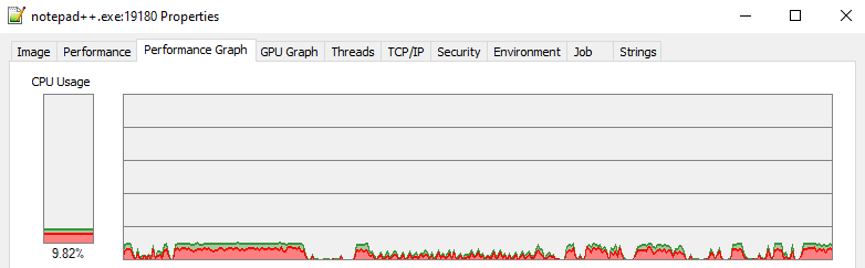

                        • mvlazaM
                          mvlaza @mvlaza
                          @PeterJones too soon to celebrate :-(
                          CPU at 12% - but look the following pattern (capture from process explorer):
                          You will notice that the are flat regions (about 12% CPU usage) - what it is interesting is that the Notepad++ windows was not on top of others (in other words, it was not in focus).
                          So if I minimize or send the notepad++ window to back, CPU usage increases, but when I’m editing the text files the CPU usage is typically lower (unfortunately this is not always true. Some of the time because of legit CPU usage for text suggestions, highlight, parenthesis prediction, etc but some are bogus CPU cycles since when I’m reading the text I expect the software to be idle).
                          Doing more tests, it doesn’t matter if the notepad++ window is covered or always shown - if it not the focus, the CPU usage will be high for sure. Tested both with dark mode on and off, same behavior.
                          Another test with a interesting result: open a modal window (like “sortcut map”) or simply open a menu (and leave it open) drops CPU usage instantly to zero. Looks like a window redraw/refresh issue to me.
                          I’m out of ideas for now and don’t know what else can be tested.
                          Thanks in advance,
                          Marcos
                            Ekopalypse @mvlaza
                            @mvlaza
                            The only two ways I know of to find out what could be causing this are,
                            run the executable with a debugger or, which I prefer, use
                            procmon to see what’s going on.
                            Just put a filter on the running process and see what it does.

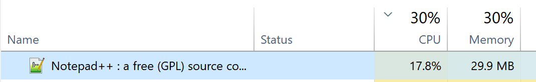

                                  Same problem here. Even with no files opened, the Notepad++ is using 20-25% of my CPU. It’s not normal.
                                  • Tried to disable all plugins but I had no success in reducing the CPU usage.
                                  • Installed 7.9.5 version (x64). Same results.
                                  • Run as Admin. Unlucky.

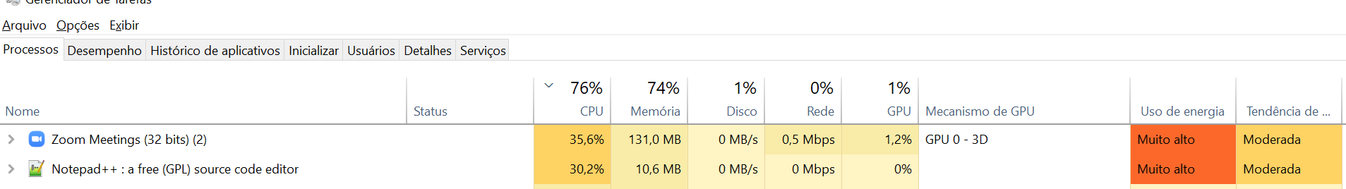

                                    • Emerson Carvalho de SouzaE
                                      Hello all,

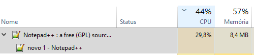

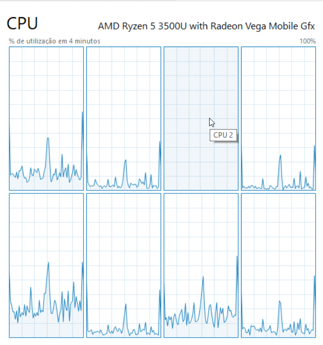

                                      For me both versions x86 and x64 have about 25-30% of CPU, without any plugin (I removed all) and with older versions too. Any idea?
                                        PeterJones @Emerson Carvalho de Souza
                                        @Emerson-Carvalho-de-Souza ,
                                        Any idea?
                                        Plenty. Most of which were enumerated above. You’ve only answered questions to two of the many queries posted above. Some that you haven’t answered:
                                        Share ?-menu Debug Info
                                        Look at the recent-file-history (either in main File menu or a submenu thereof), and make sure there aren’t any
                                        Look at your current session and see whether there are any network drives or mapped drives for the files that are open.
                                        Look for virus scanners or the like that might be interfering with Notepad++'s running.
                                        Try a portable edition of the same version and see if it behaves the same. Try a portable edition of a different (newer or older) version and see if it behaves the same.
                                        Is it only when large files are loaded, or any time? (If so, how large?)
                                        Is there a syntax highlighter lexer enabled (ie, is the Language menu selected None (Normal Text) or one of the others. If a different lexer is enabled, if you manually change it to None (Normal Text), does the CPU usage stay high, or does it drop to reasonable levels
                                        If you exit and/or reboot, does it stop using large CPU levels?

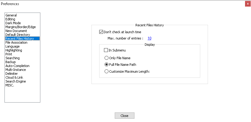

                                            You don’t say whether that was a local path on your machine’s HDD/SDD, or whether it was a network path. Which is really the information I was going for. But you could try File > Empty Recent File History and see if the performance improves when you restart.
                                            Or, as noted above, do the Settings > Preferences > Recent Files History and turn on the Don't check at launch time, which makes it so Notepad++ won’t try to see if files in the Recent Files History still exist or not.
