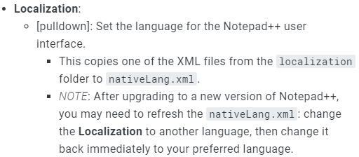

                      The manual states:
                      It might be a bit “weak” as it doesn’t explain how you’d change some UI text, and then what happens to get your next text realized.
                      Also, I’ve noticed that you don’t actually have to change to a different language in the dropdown. So… say your current choice is Italiano and you make changes to that language’s xml file. You don’t have to change away and change back to Italiano, just dropping down the dropdown and reselecting Italiano is sufficient to cause changes to be picked up.

                          The “binary translation” page goes a little more into how to edit it… but probably not enough (let me know if you think it needs work).
                          There needs to be a link from the Localization preference to the “binary translation” page, if nothing else. issue #253 created
                          The intention was for the binary translation page to show how to edit that.
                          I wonder if that’s changed behavior or if it’s always been that way.
